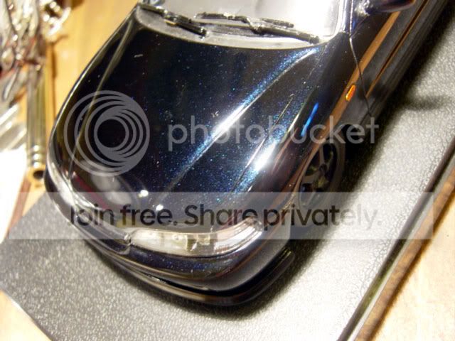

honestly if i were you..and i was wanting pearl in the black i think i'd just go with blue and silver
UA code (black) with prlx4 (blue pearl) and prlx2 (silver pearl)..the PRLX is actually a plastic pearl that gives a different pop and side tone than regular metallic......PRL is cheaper but PRLX is a little more vibrant
