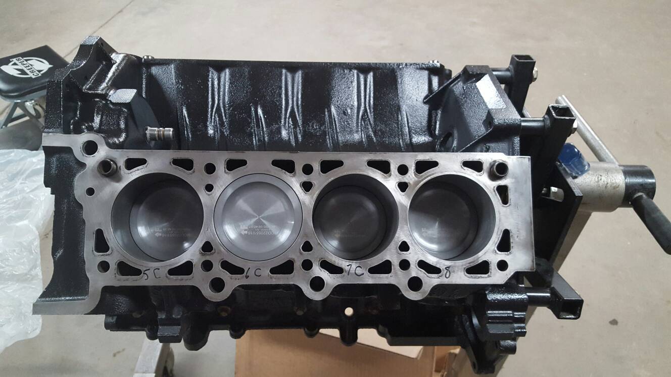

Well shortblock is done. It time to pull the other engine out to rob the heads and timing cover. Car should be back together in the next couple of weeks or so. Didnt expect to have a built shortblock so quick this year.

Well then, you got that one out pretty quick lol.
By the way, what stand is that red one? I like how wide the stance is.
