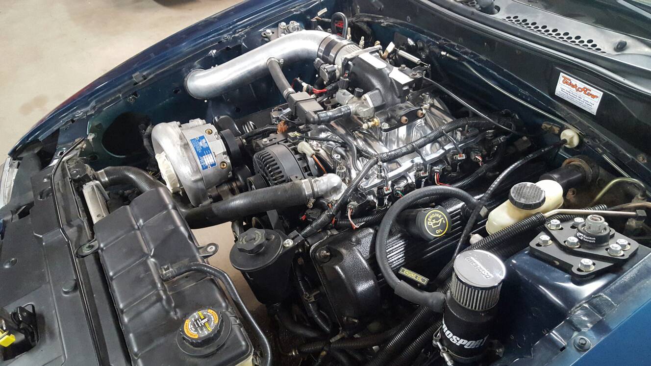

Well in my luck the satin intake I ordered were completely out of stock everywhere and did not have a ship date tell late March. I ended up going with a polished one. They felt my pain and I got it for the same price as satin. Not much of a fan for shiny stuff in the engine bay so will probably eventually get it powder coated. Hopefully I'll get it by this week yet or early next.

I would say the first start was a success. Some fine adjustments to the fuel and I think it should be ready to head to the dyno
