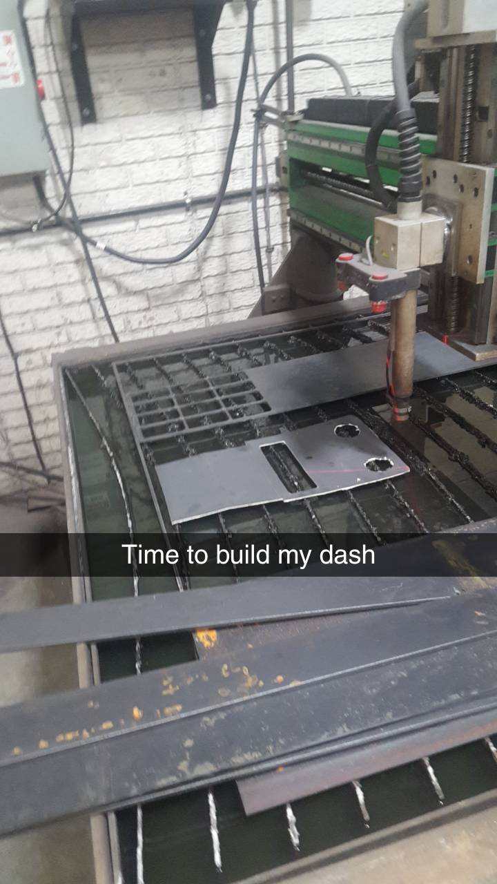

Also was able to finally finish the center dash peice. Turned out pretty good. The third gauge will be a fuel pressure gauge should be here by the end of the week

That dash plate looks awesome!
