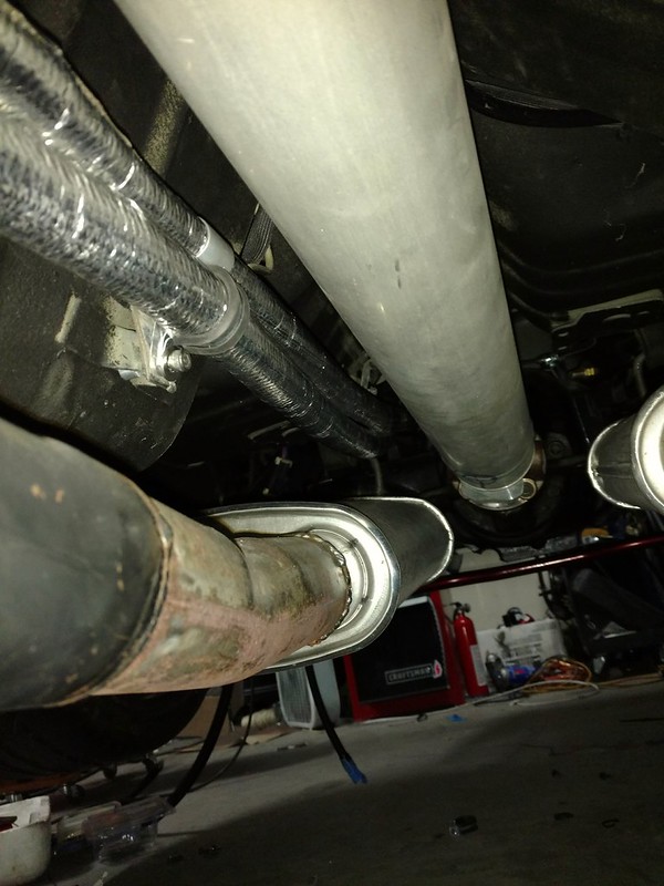

lol I thought the EXACT same thing before I got the hose. Once I got the hose and started to try and figure out how to get it ran around the axle and the rear control arms which looked like some fun only to leave me to run the hose directly above my side exhaust mufflers where it would be REALLY close. In the end I opted to get some insulation wrap for the section above the exhaust. I can probably get some pics today, have you ordered your parts yet?

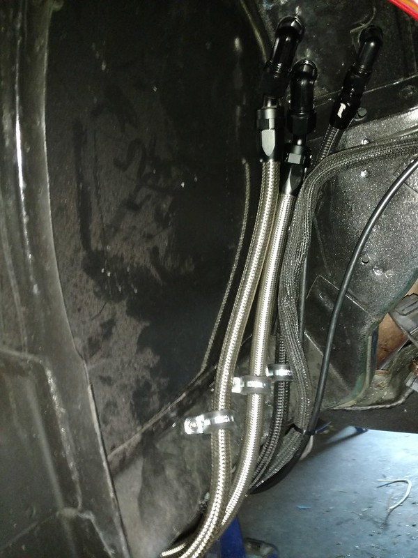

It was actually the exhaust tip the hoses would have ended up basically resting on top of so instead I went the stock rout. Here you can see the insulation(vibrant performance) as well as the brackets I used or made to do this. I wanted to be able to mount both lines with a single screw and could not do that with the brackets I found to buy. I got the rubber lined mounts at my local ace hardware but you can save a bunch if you order them online. The other mount I made by cutting some strips of scrap aluminum I had and then putting heat shrink around it and drilling a hole in it. This allowed me to put them where I wanted and again both are held with a single screw.

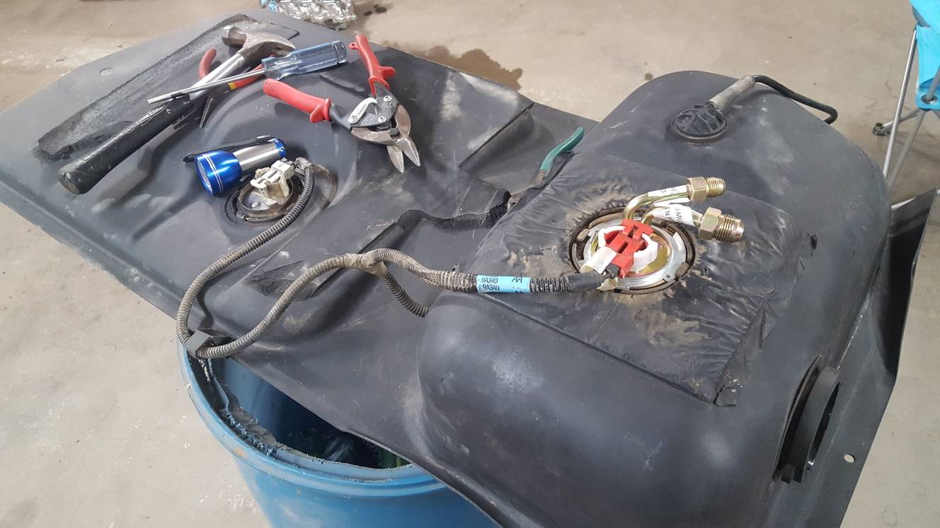

I ended up doing my system backwards because I originally was only going to swap out the fuel rail/regulator but then the system I got(trickflow by aeromotive) splits the feed lines and then one goes to the back of each rail. The only problem there was that I got rid of the stock lines under the hood where it was set up to split the feed right where the stock lines merged, and there was not much space then to fit the splitter and fittings in between the rails and the fender where I made my lines feed in. So then I decided to go ahead and run new hoses all the way back and go with pump/filter outside the tank mainly because I had to drop my tank to figure out why my level sender is not working. Here is my -10 feed that goes to the splitter that then has two -08 lines.

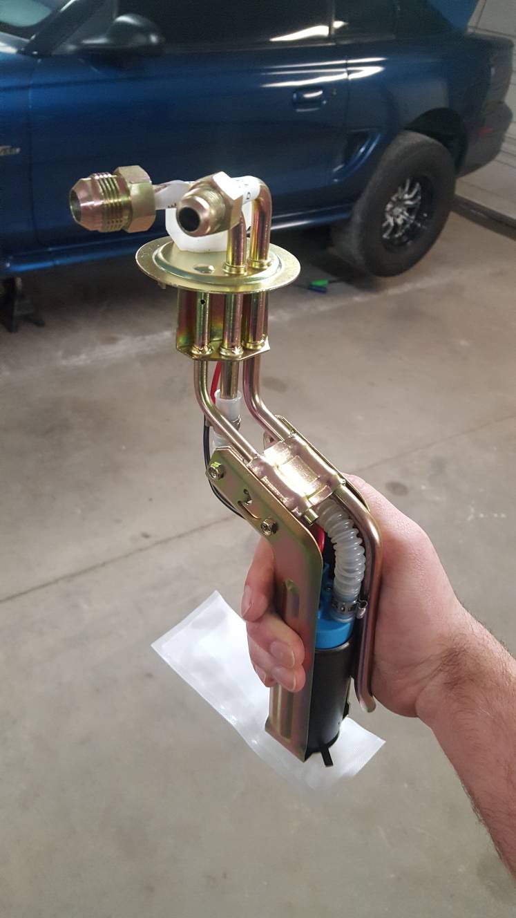

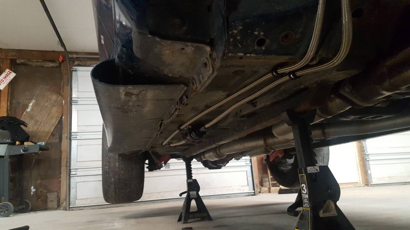

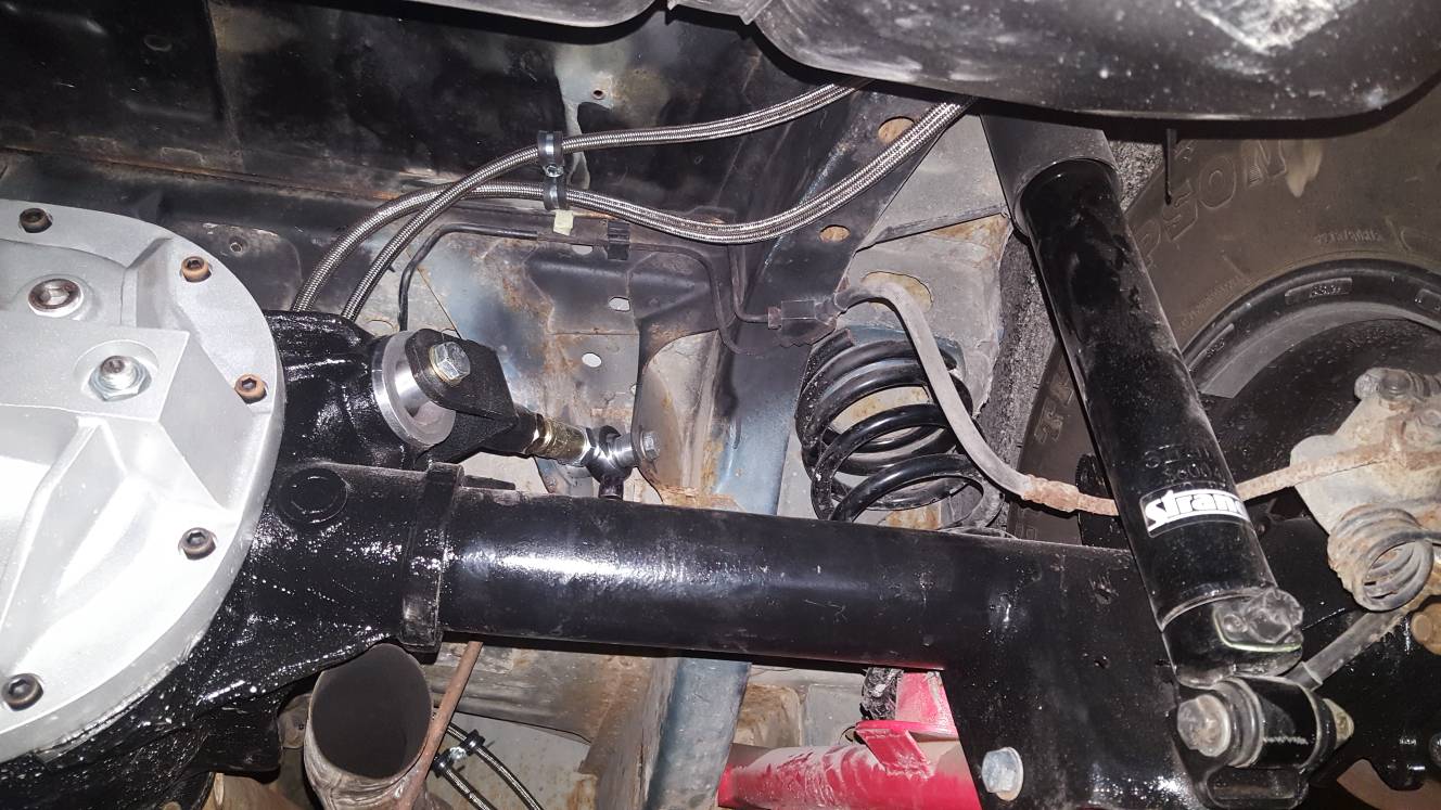

Started tackling the fuel lines today. Gotta say the quantum fabricated fuel pump hat is a really nice peice. I ended up going with some of the factory routing to make it around the passenger rear upper control arm.... I alo mounted both lines higher away from the exhaust. I then 90'd both lines under my subframe connectors and along the passenger frame rail. I'll get some better pics after it's finished. Now I'm stuck waiting for my intake manifold that modular head shop should have had shipped out by now. Hopefully I'll get by the end of next week.

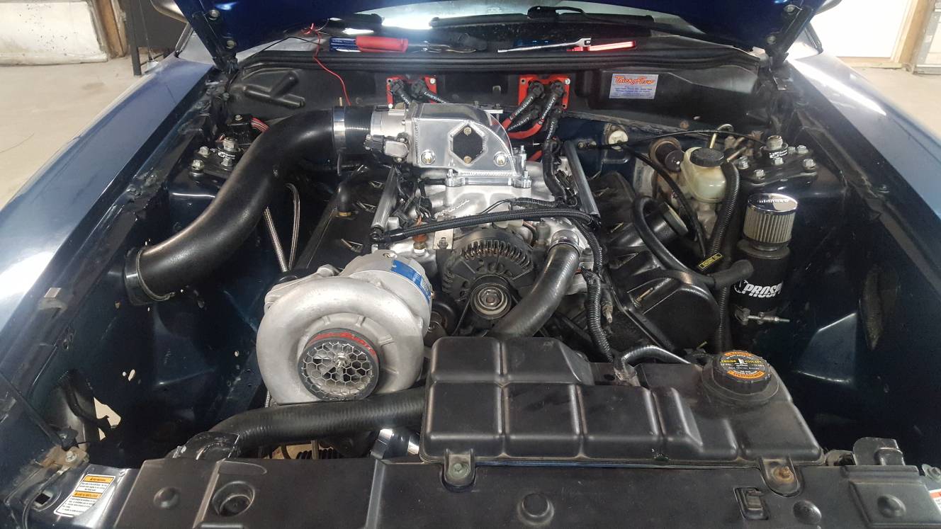

Got my intake pipe welded up. Fired the car up and set fuel pressure. Car is running strong.

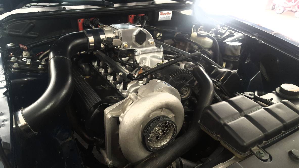

Alright she's finally done. Changed the blower and engine oil. Finished modifying the "S" pipe in the engine bay and made a new easily accessible power pipe I can change out quicker at the drag strip.
