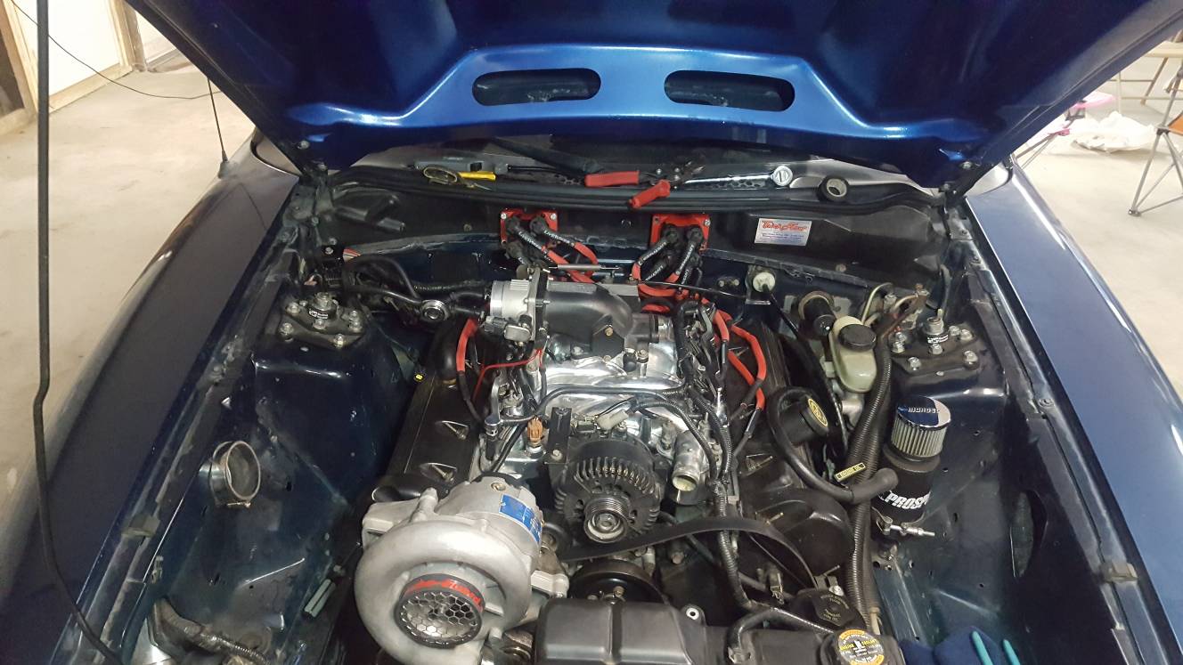

Started pulling back the engine harness to relocate the coils to the firewall. I HATE wiring

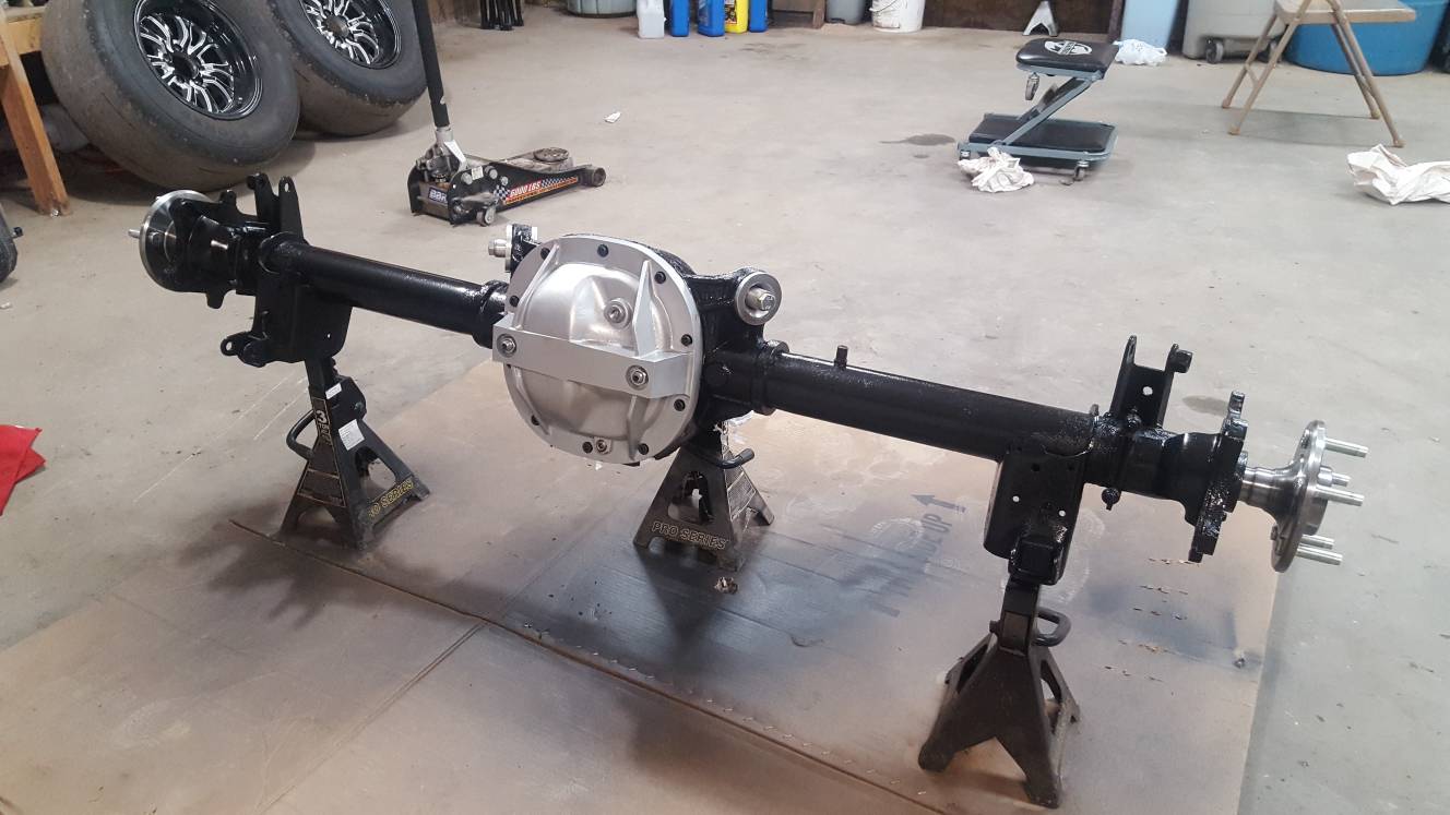

Got some needed work done this weekend. Coil packs have been relocated to the back of the engine bay and the 8.8 is finally built and ready to be thrown back into the car.

What all did your rear-end build include?
Eaton LSD - Moser 31 spline axles - I kept the 3.73 gears - New axle bearing and seals and some spherical bushings. I also have a Team-Z Anti Roll Bar going on it. I prettied it up with some fresh paint and a diff girdle cover.
