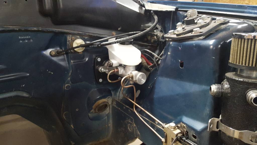

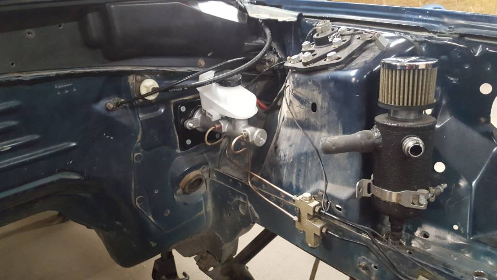

Thanks for the info, Im sure I will have more questions for you on the way. My hopes are to keep the stock proportioning valve and just tap both lines into my new Master Cylinder. The MM converision comes with master plate and brake pedal right?
I’m still using the stock proportioning valve and just new lines from the master to the valve. I’m going to replace it though because the rear brakes don’t get much pressure (not a bad thing for a drag car).

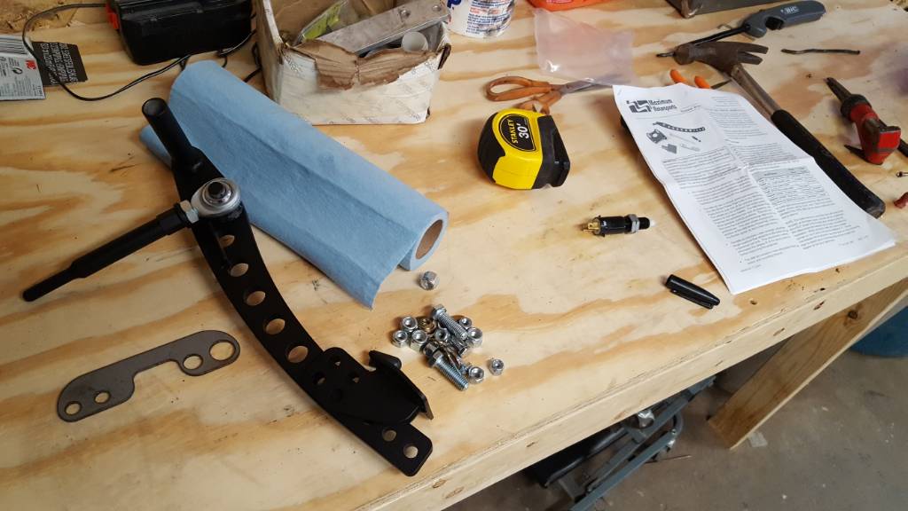

The MM kit comes with the plate, and adjustable push rod, pedal arm, pedal, new brake switch and bracket, and very good instructions.

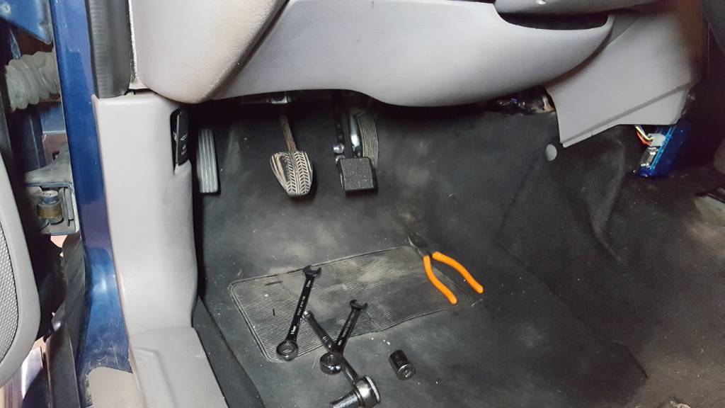

Time to get these brakes switched to manual
