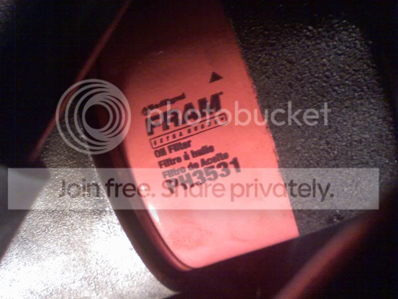

this technique worked 100% i can't believe that something honda made 20 years ago or so slides right on a 4.6 mustang motor.. lol
used a fram ph3531, will be a temporary fix until i can get some new motor mounts.
