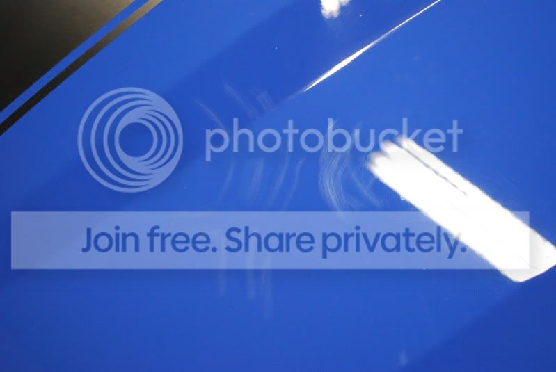

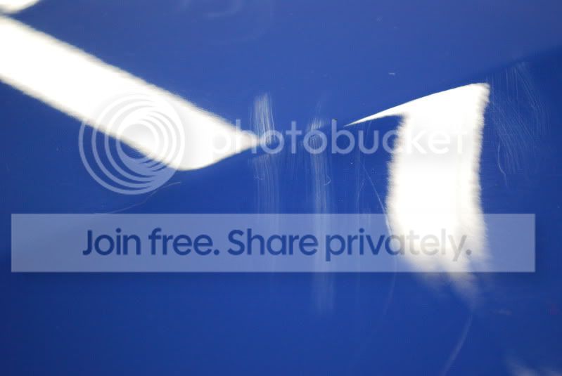

Finally, some pics of the carnage. I found a new home for the cat so this wont happen again. These are just a few of the scratches. There are bigger ones all over the car, especially on the roof. And there is also a giant rectangle (about 5"x4" or so)of what looks like somebody took some fine sandpaper to it. I tried to take a picture of that but I wasnt successful.

as long as the scratches are not into the base coat, they should buff/polish out.
If they're all the way through the clear coat, your screwed. The scratch will then have to be sanded all the way down flat and fresh clear coat applied.
To me, the pics look like they're only surface and should come out with rubbing compound and polish.

I agree, from the pictures they do look like they will come out. Have you thought about Megs 105/205 Combo? 105 will take out some pretty bad scratches and swirls with the PC.

for the looks of the pics, everything will come out. I have this happen a few times year where a cat scratches my hood. Its happens, and i just buff them right now with my rotary or PC.
