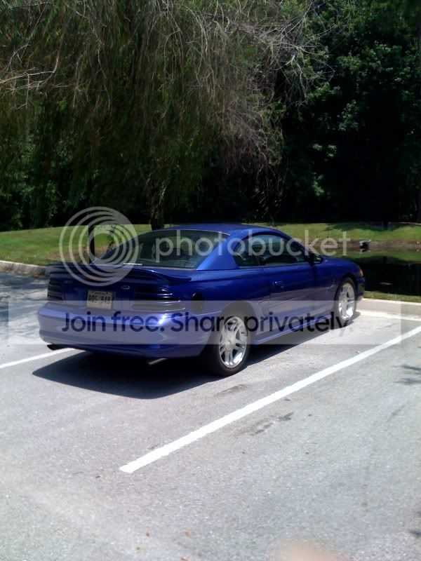

Do you think my car would look better with the wheels painted black?? Do you just sand and paint or what?? Any advice will help Thanks

i say leave it as it sits. it looks good. especially with the tinted tails and spoiler.
what kind of spoiler is that nyways? i want one!

I honestly dont know the name of the wing i think someone said it was xexon wing or something but not a 100% sure.
I wanna paint the wheels black because it just seem out of place with the sapphire blue paint plus ima finna tint the windows and since the tails tinted, the side markers tinted, gas door black, and finna paint the bottom of the rear bumper black i thought what the heck paint the rims black too.
