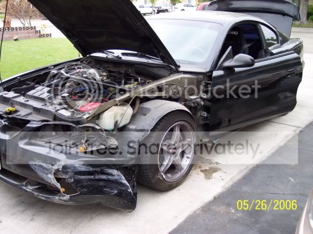

taking the fenders off is gonna be a waste of time....trust me. take a look at this pic....
why do you want to take off the manifolds while the heads are in the car? trust me, wiggle them around a bit and the heads will come out, manifold and all. just make sure its not getting stuck on the mid pipe (hopefully you removed this instead of just unbolting it).
