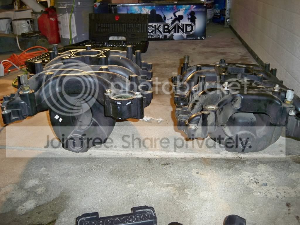

Oh and my to make sure it hasn't already been done how can I tell ? What is different mine has a aluminum crossover now .
1997gtRioRed
Sep 29, 2011
2,272
201
From the front of the car if the first runner goes left ( Passenger side) it's NPI, If the first runner goes right it's PI.
PI is on left, NPI on right

First one goes to pass. Side. I will start shopping lol. I thought maybe I would get lucky ..
