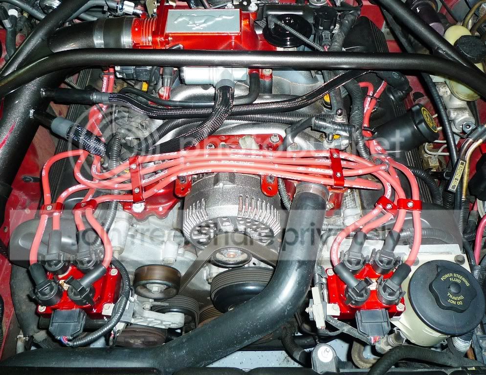

Hard to see because I painted it the same red as the crossover but here you go, non-pi alt with a PI bracket, works prefectly, just needed to drill holes for the wire holders

There is one bolt connecting the bracket to the alt
