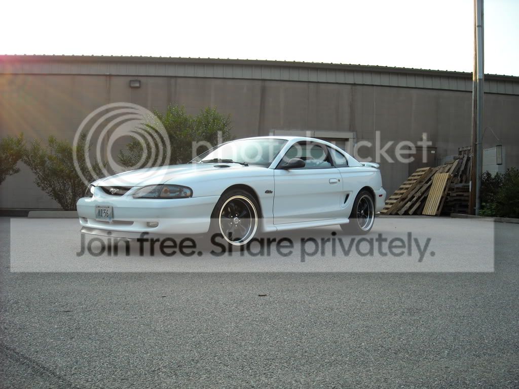

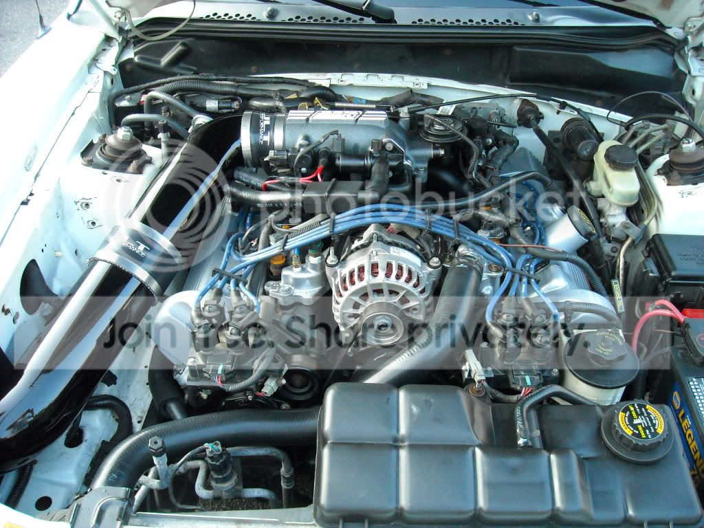

after a little over a week in the garage she's finally finished.. :headbang:
Parts list
- pi swap kit from parkway performance ( minus the heads, already had a set with low miles) ..ported&polished pi heads
-bbk 78mm throttle body/plenum
-JLT fenderwell style CAI
- Pypes stainless shorty headers
- Pypes high flow catted x-pipe
....a few subtle appearence mods as well
- 14 in shorty antenna
- rear bumper inserts
i couldnt be happier with the way it came out and it sounds greattt. here are some pictures..let me know what you think

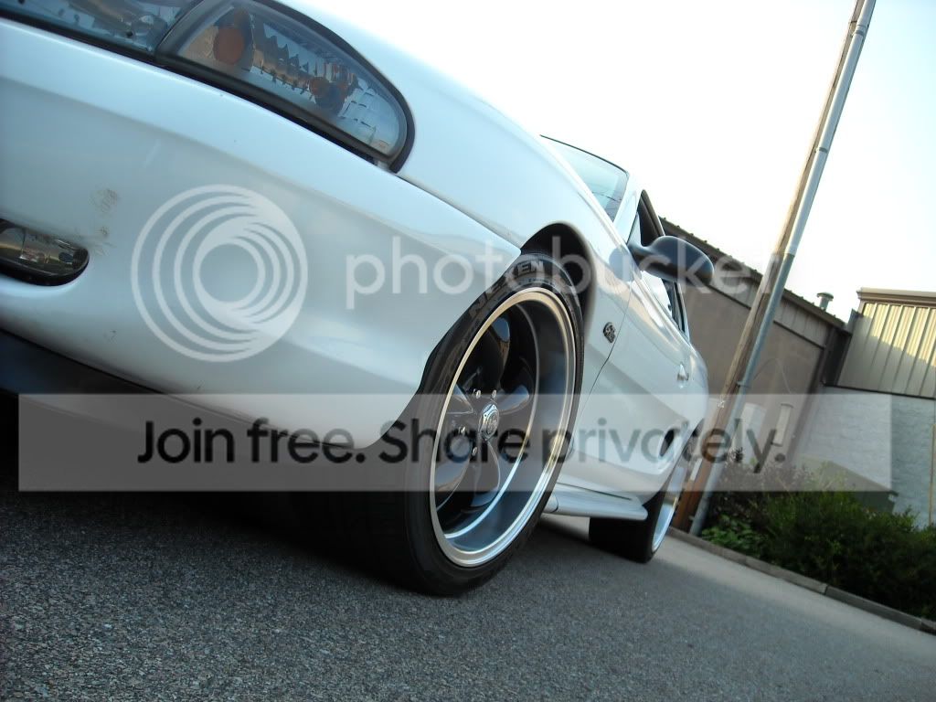

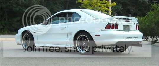

some pics i took today..
