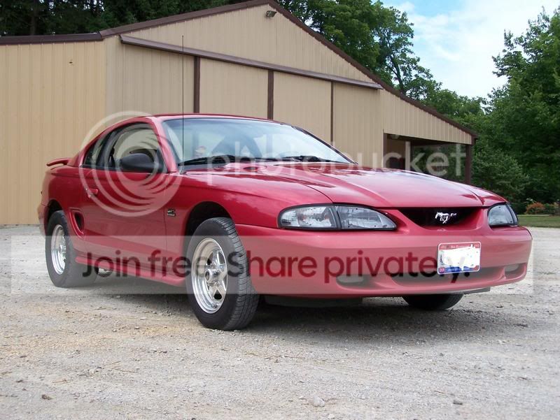

Pics of my 95 GT
red95gtcoupe
May 4, 2007
31
96stangRC
Jun 4, 2006
74
nice car....I love laser red 95 GT's with smoked headlights ;) Also, whats your setup to make the skinnies fit. I'm looking to possibly get pro stars or some sort of drag wheels for my 95 and have heard that most people have to use spacers, longer studs, and grind the calipers.
R
red95gtcoupe
May 4, 2007
31
Thanks guys. It is a 15x5 prostar in the front with a 165 tire. I had to get 3'' studs and use a spacer (i forget the thickness). The rears are a 275/50/15 M/T drag radial. It does have a 4x4 stance. Hopefully Ill be getting some coilovers soon with some drag shocks/struts. I forget the headlight brand, but they are from ebay. I had to search awhile before I found them. I didnt want projectors or some of the other ones that are common on ebay. I think these ran 90 or so before shipping. The M/Ts are about shot and i think ill go with a real ET Street this next time. I suck at launching with DRs and the best 60' so far is 1.75. Hopefully a wrinkle wall tire will be more forgiving on the launch.
