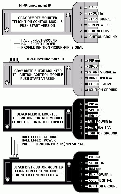

Like I said they will not!!!! Explain were you will plug the other connectors on the side

Okay well what's on the bottom of the SN one? Accel AND Mallory list them as being the same from 83-95 so it will work. Show a pic of the bottom of the OEM style. Just because they don't look exactly the same doesn't mean that they don't do the same thing...

don't fall victim to the xx-95 marketing. that doesn't always mean its going to work as you expect it to on a 94-95. more often then not it will technically work but that doesn't mean it will work as factory. perfect example is water pumps. there are like 30 different ones for the 302 but only one that will work with the 94-95 timing cover. and yet almost all of them say they will fit 79-95.

Seriously.. Ok sure it will work..if you want it to work so bad.. You are right I'm wrong.. Even tho I replaced both before.. If you go back to page one there is a pic with it on the hear sink..
2011-03-23_010342_1994-95-mustang-5-0l-thick-film-ignition-module-tfi_17058421873012222222222222222.jpg
95 one
