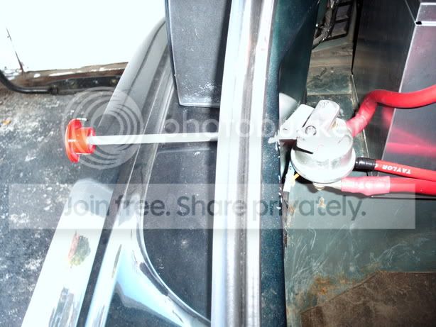

Here is this setup on a new edge
And a real nice sn95 setup
NmcgrawJ
Jan 11, 2006
139
i was gonna say....
no need to drill lights. the gap abovethe bumper provides more than enough clearance....like above.

Cool thanks for the info! I never thought of doing it that way :)
