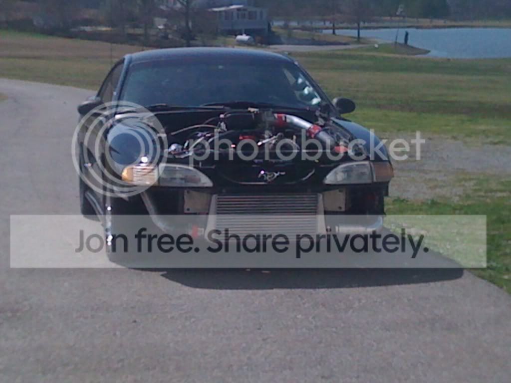

Is that Twin turboed and supercharged? Looks like the old roushcharger on the 98s almost.. I want more pics please :) :)

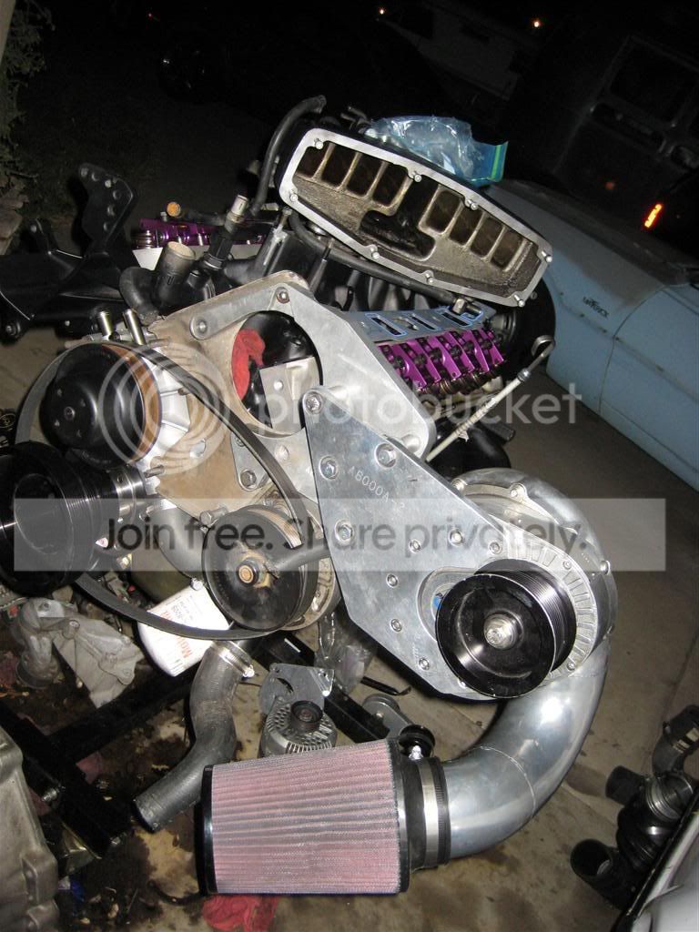

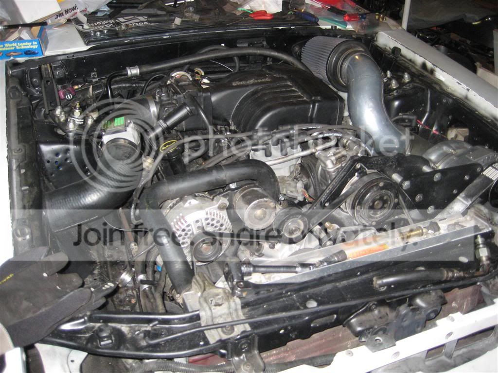

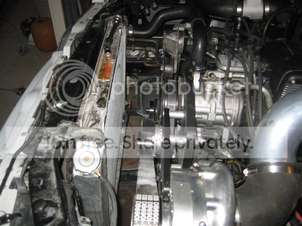

the usual run of the mill S-trim with a custom bracket for the tensioner. its now in my 94GT, but not picture-clean yet
That's the M90 set up on a V6. All the extra piping is to the FMIC off the top of the blower, then back to the lower intake at the firewall. I love that set up, wish Ford had it as a Mustang option back then.

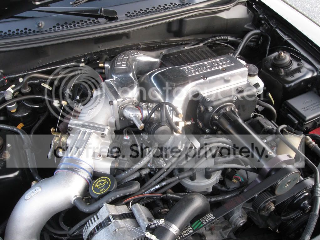

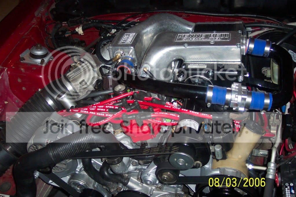

Here's Mine: ;)
Nothing fancy 1.5 kenne bell with the 10-11 pound pulley
running a lightning maf
42lb injectors
255 hi flow fp
Snow performance meth injection
COP conversion for an even cleaner look :p
This is an old pic already! The car has a Moroso aluminum coolant reservoir and a new coolant cap! also running a 160 thermostat
