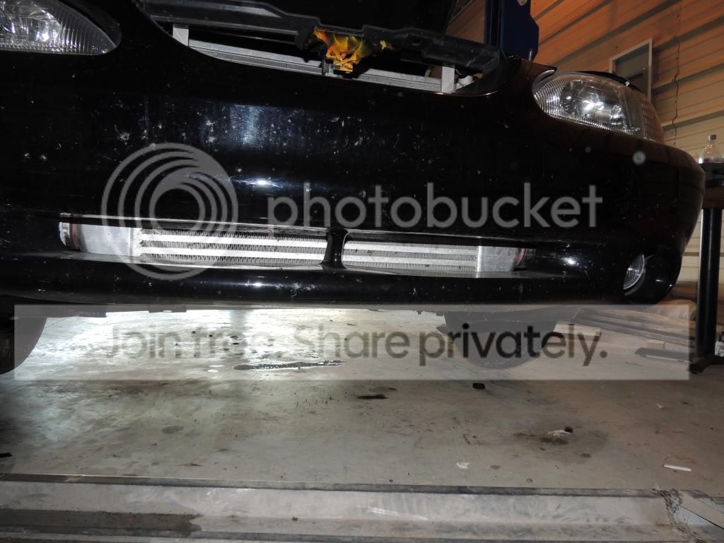

My car currently has 0 overheating issues, no matter the time of day, or day of the year. I can push it hard and it wont over heat. temp says at the middle or below. And thats with stock replacement parts.
Do you have photos of how you have the intercool system set up on this car?
Dont really have any pics that show how the intercooler is mounted, nor the piping. As for the routing, the piping goes from the sc which is a straight discharge, clocked to about the 7 o clock position. It points down and slightly towards the passenger fender. The pipings run from there to the intercooler inlet on the passenger side. The outlet is on the driver side. Comes out on the driverside, and crosses back over to the passenger side, and then goes up and into the throttle body.
