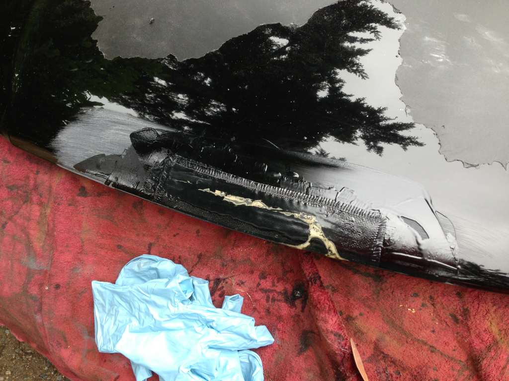

Picked up a Fiberglass repair kit and repaired the cracked hood this weekend.

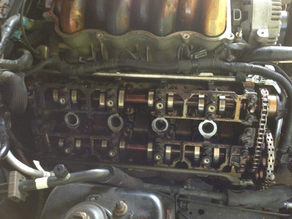

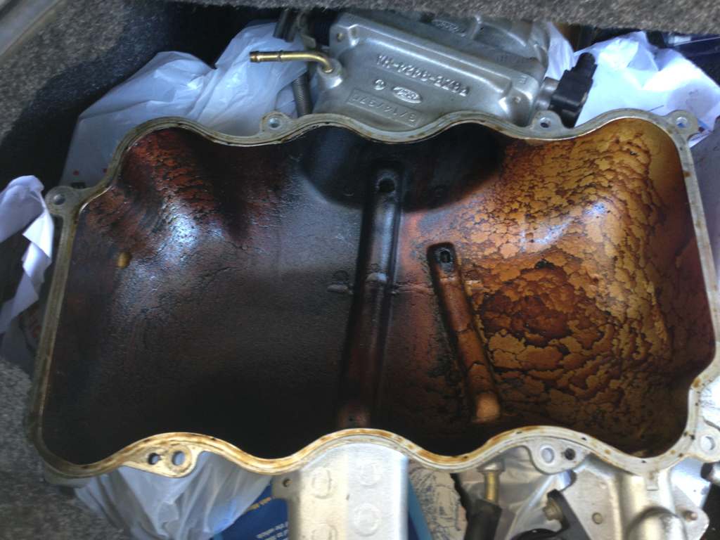

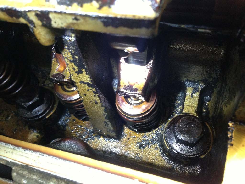

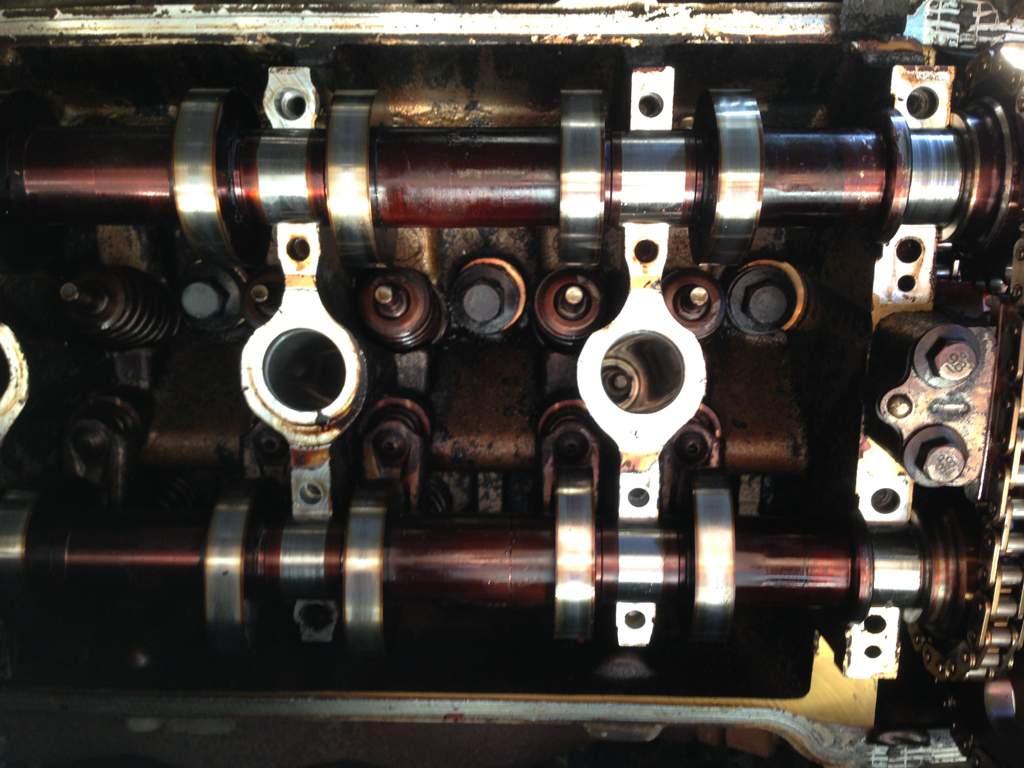

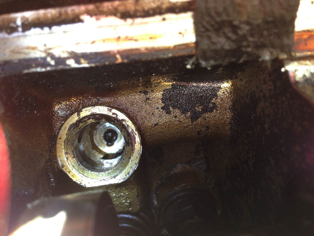

Well this past weekend wasn't good to the Cobra. I was on my way home from work when the car started stalling and lurching. Then I heard loud noises coming from the engine. I limped her home. I suspect it is the oil pump as no oil is getting to the top end. I started pulling the top end apart to inspect the cam, lifters, and followers. Nothing broken and all the cylinders have good compression.
More pictures and details to come as I pull it apart to find the failure. I have ordered a new FRPP Oil Pump and Canton Oil Pan.

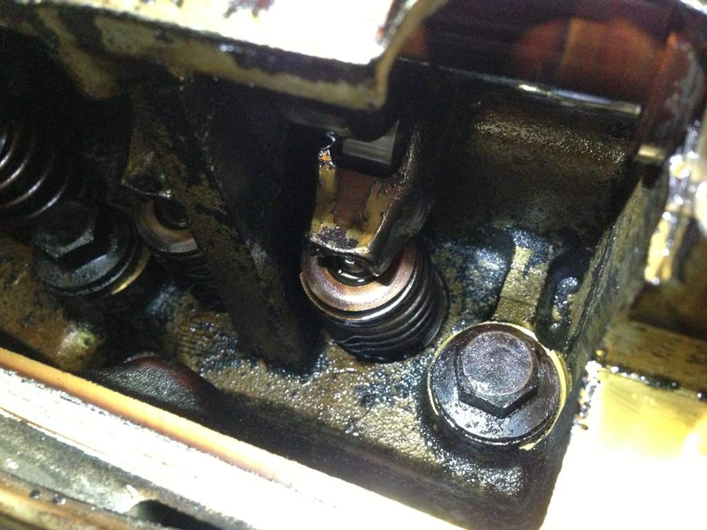

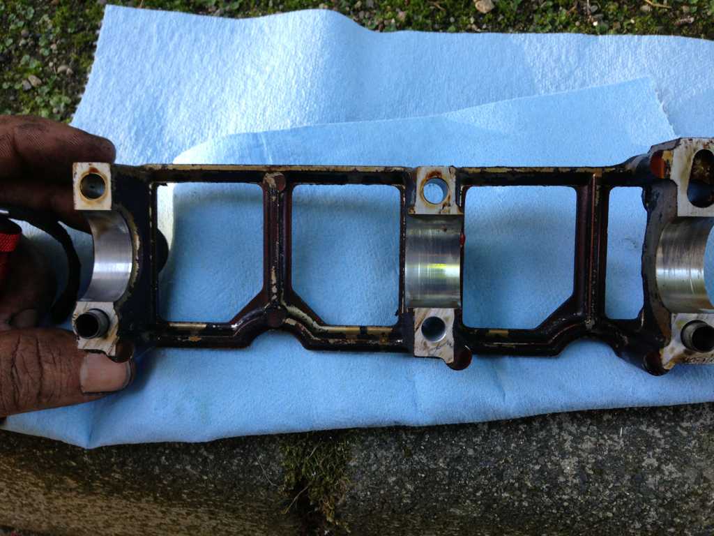

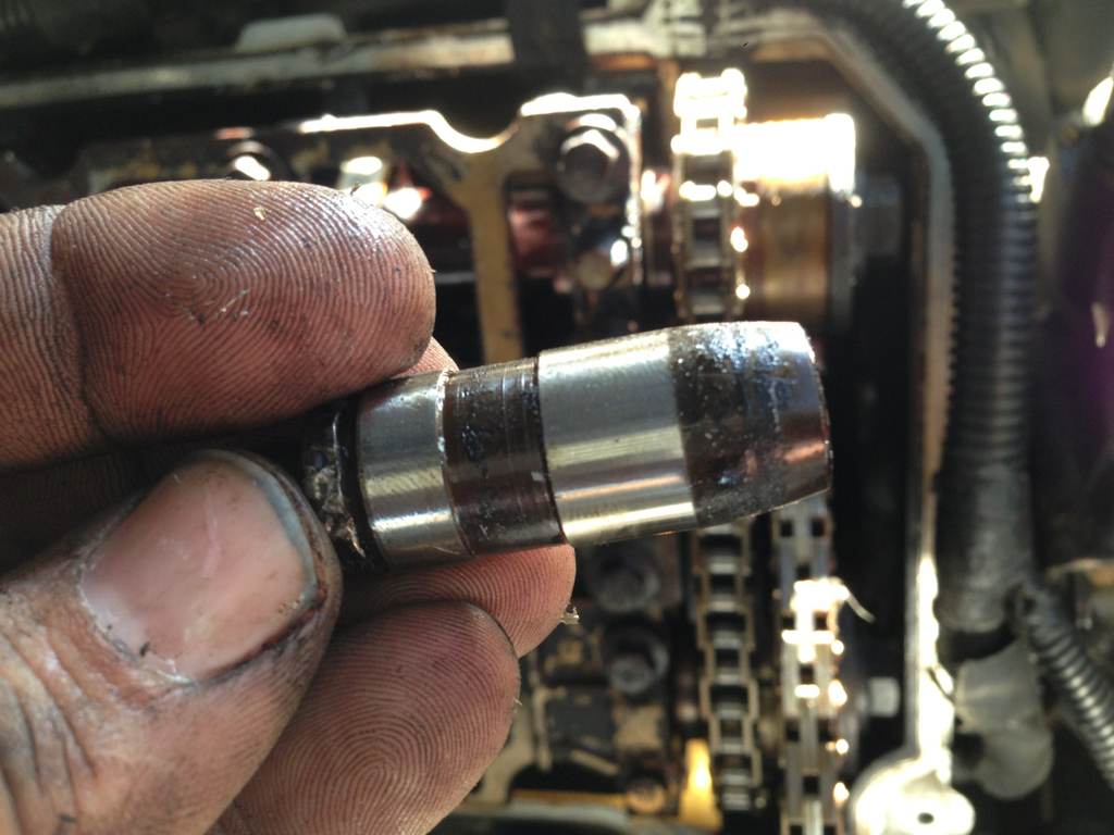

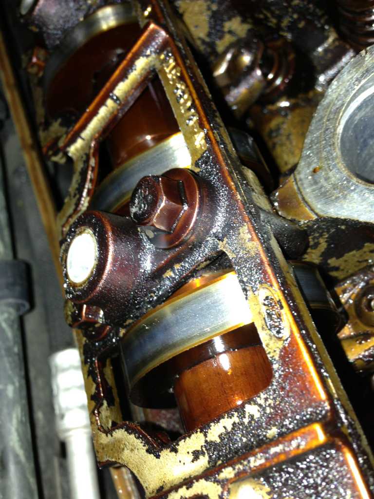

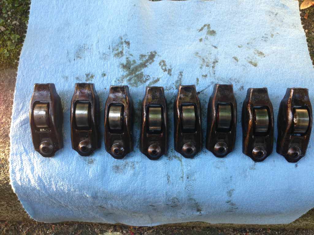

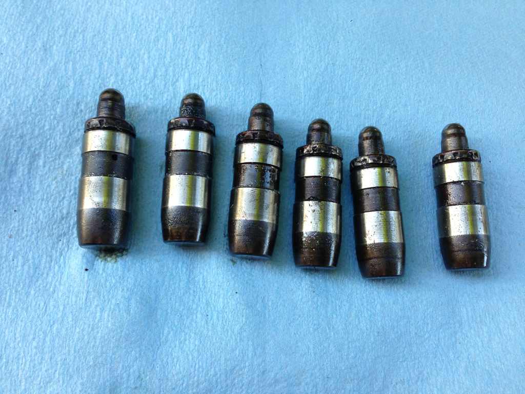

Pulled more of the top end apart. Most defiantly oils starved. The cams are not damaged, nor are the valves or followers. The Lash Lifters were very dry and gunked up. Signs are pointing to failed Oil Pump.

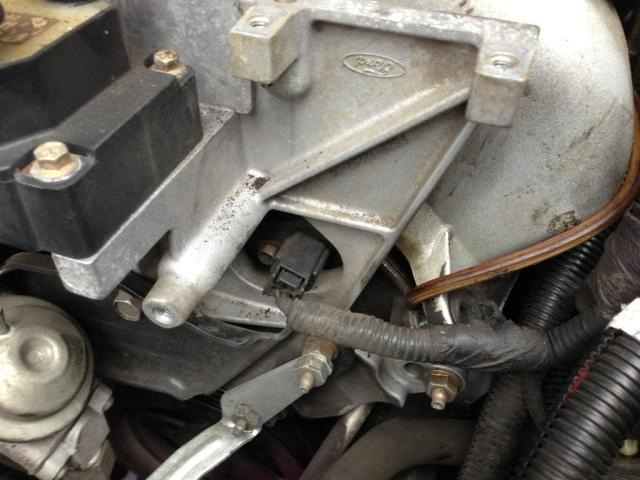

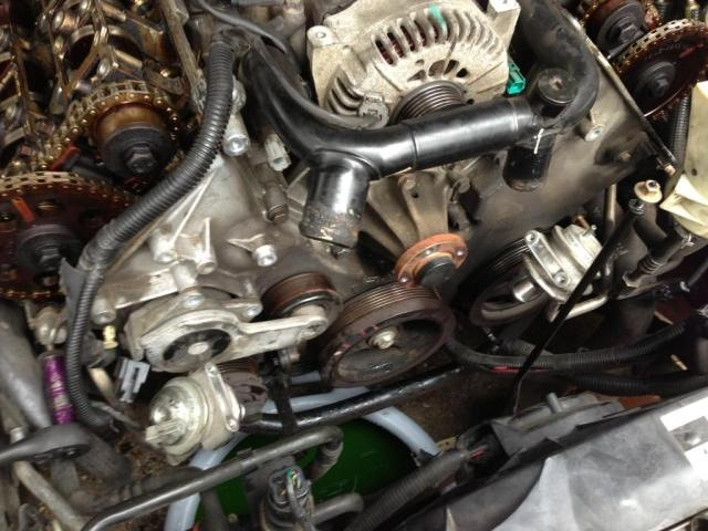

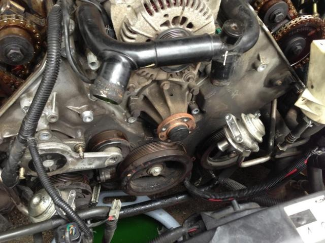

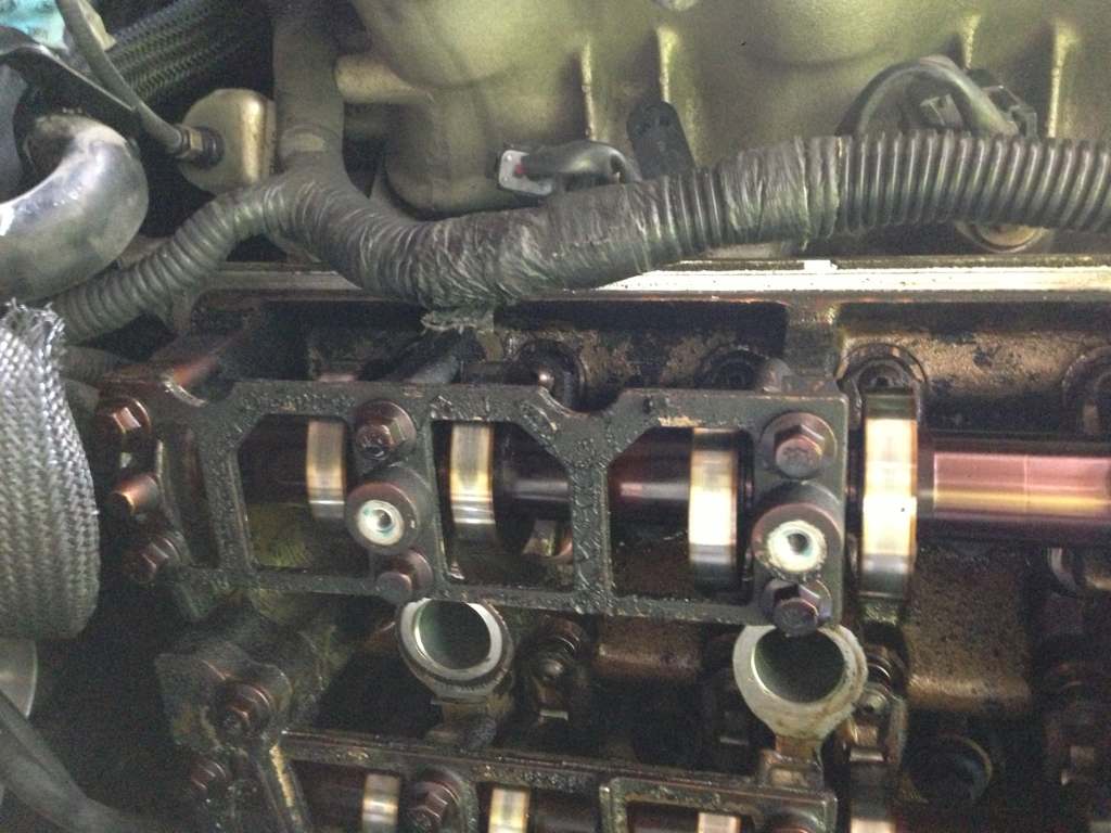

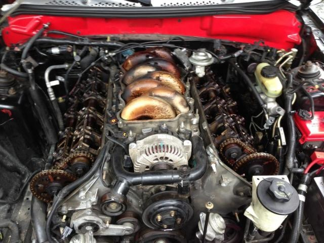

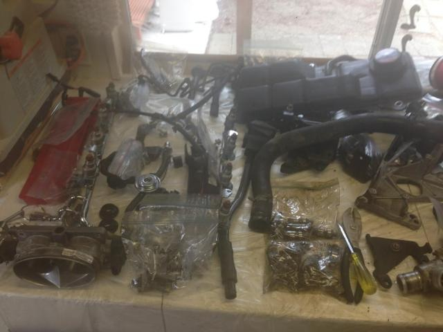

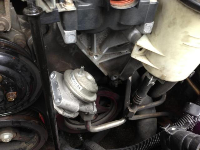

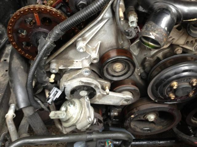

Pulled some more stuff of the engine. There is a lot of stuff to pull off before you can take the timing cover off to get to the oil pump.
All removed parts are organized and bolts in labeled baggies.

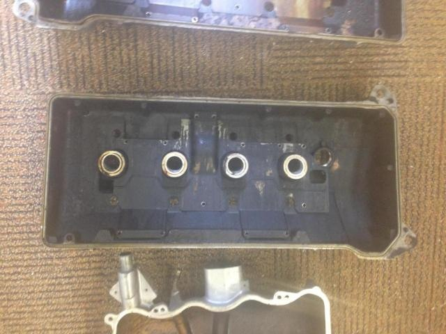

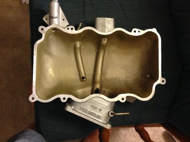

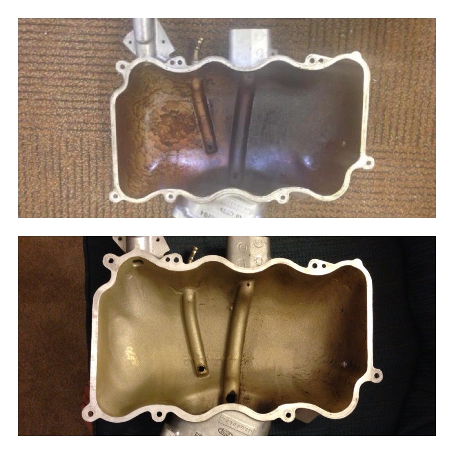

Had a friend take my Intake & Valve Covers to his work to clean them in his parts washer. I'm happy with how clean they turned out.
Valve Covers Before:
Valve Covers After:
Intake Before:
Intake After:
Side by side:

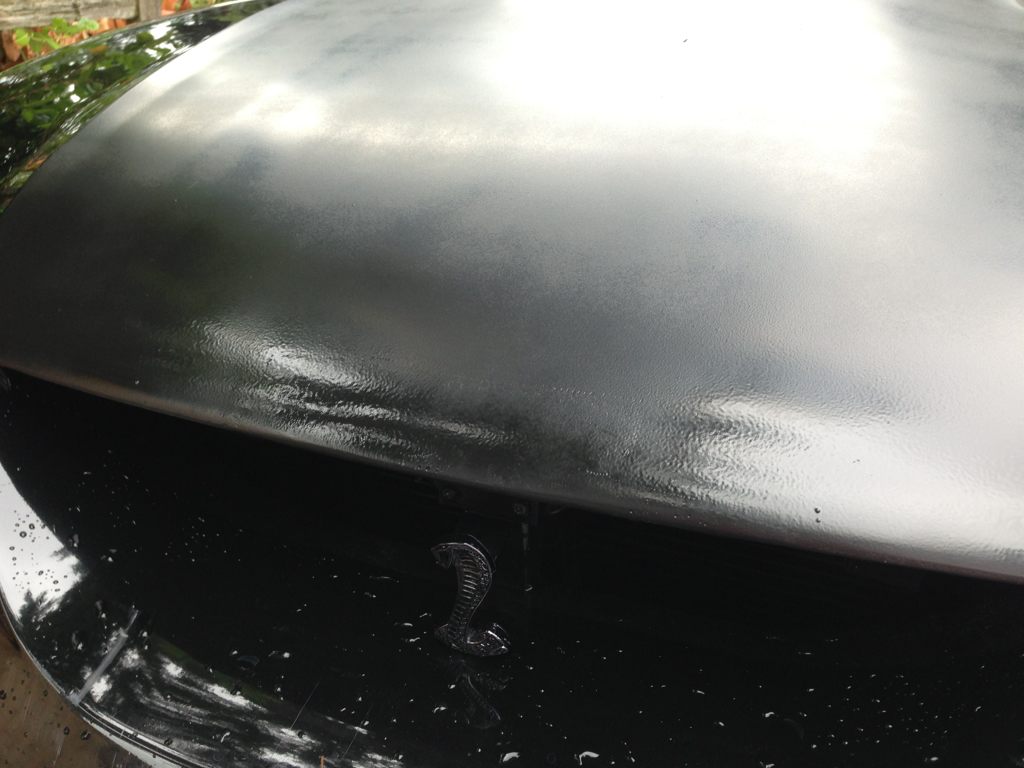

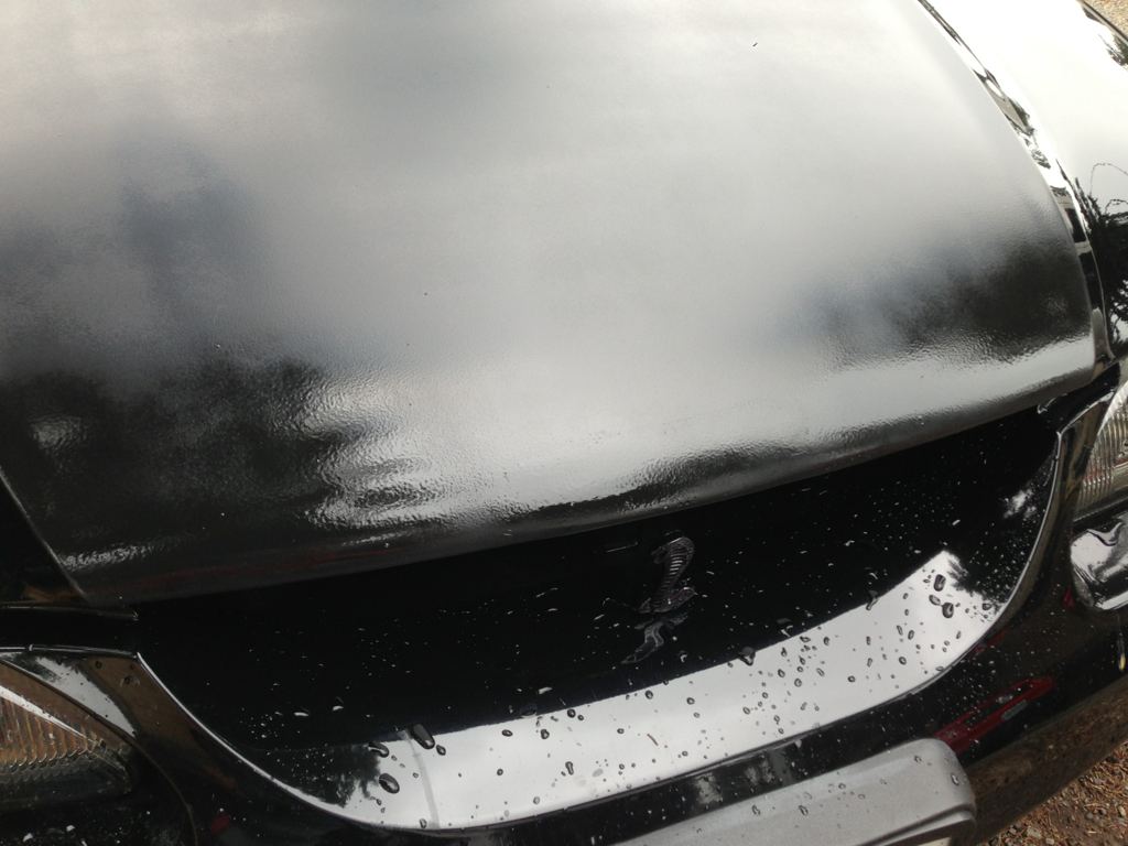

Awesome build man! If you do find anything wrong with the engine or are are looking for parts for the heads let me know. I have a set of B-Heads from a Mark VIII laying around. I guess they are different intake cams, but everything else is the same part number for part number. I have no use for them so just let me know. Sweet looking car though. Did you just use plasti-dip on the hood or just a flat or satin paint?
woody
woody
Mar 7, 2013
117
Mukilteo
Thanks - Yes I Plasti-Dipped the hood. I damaged the front and repaired it with fiberglass. The Plasti-Dip is temporary until I buy a cobra r hood.

Damn sucks to hear about the oil pump. Hopefully you didn't do too much damage to it. How many miles are on that engine? Looks like it wasn't treated to well.
woody
woody
Mar 7, 2013
117
Mukilteo
115,000 miles, I'm the second owner. I will most likely be pulling it after all and replacing the crank and bearings. I will know more after pulling the pan to check the rod bearings.

Looks like the first owner didn't like changing the oil. Good luck with it man! Hopefully the bearings look good and you caught it early enough.
