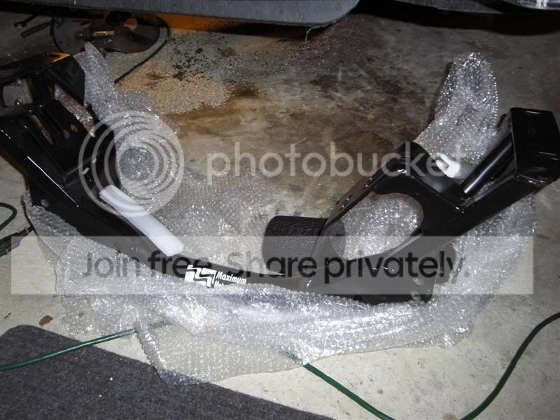

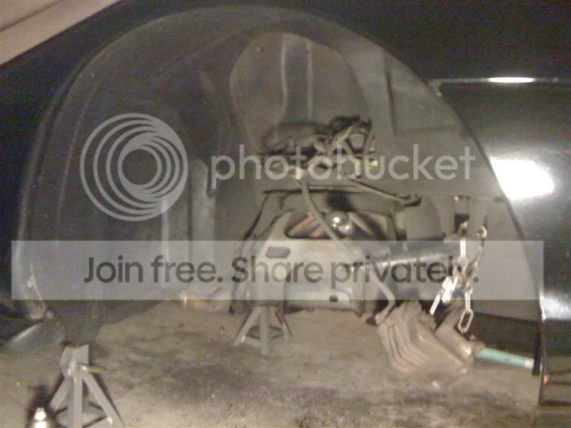

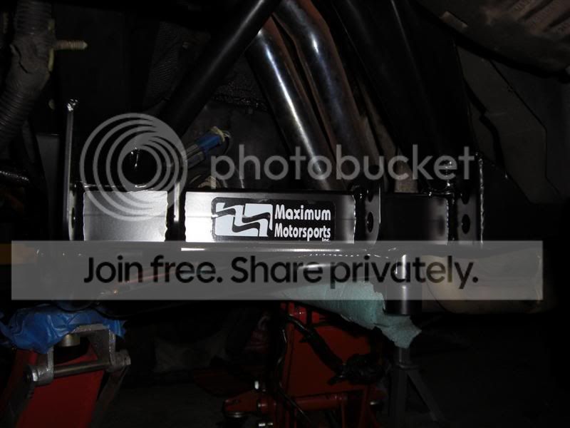

Well slight update, slow and steady progress. Now I'm just waiting on caliper paint and then there are NO MORE EXCUSES why I shouldn't make fast progress after receiving the paint. Started assembling the coil-overs and painted the spindles to kind of clean everything up. Got one control arm on and torqued everything down on the k-member to spec. I was kind of disappointed with Max Mot for a design flaw. The motor mounts on the k-member don't leave you enough space between the mount bolt and the one upright tube. I couldn't fit a standard ratchet and regular wall socket in the space to tighten up the mounts let alone fit a torque wrench in there. Solution was to sacrifice a wrench and frankenstein a bar to the one end of the wrench for leverage. More to come!

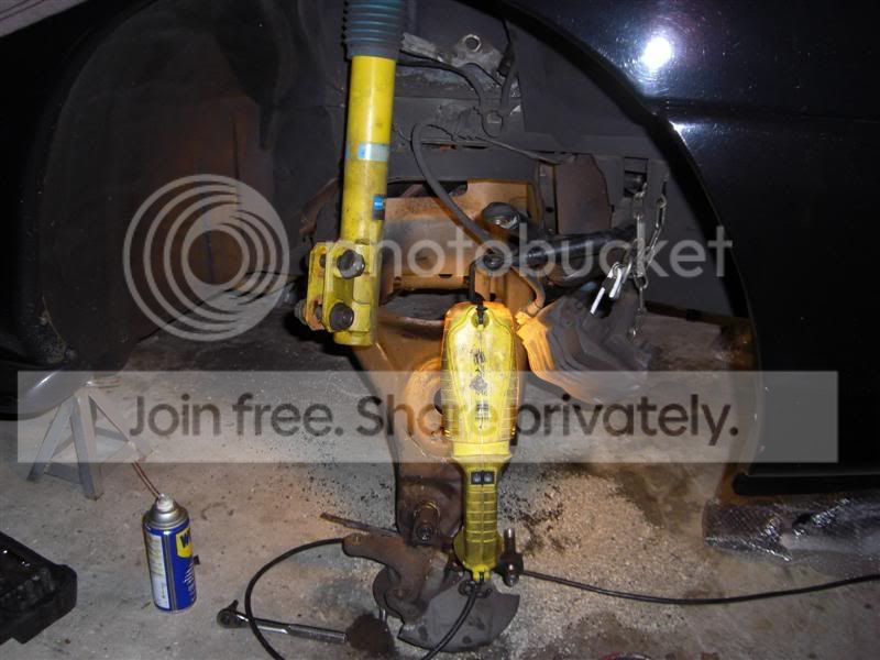

Worked allllll freakin day today! :sleepy1: Here's the results after hours, hours, hours and a few beeers:
Still waiting on the sway bar end links and relocation kit but besides that she's ready for the alignment shop!! Now I just need to tackle the rear-end and we'll be golden!

Well so far I barely drove it lol. Trailered it down to the shop yesterday and had it aligned only to find out the k-member is a 1/4" outta square and the coil hits the strut tower :BangHead: :BangHead: Back to the drawing board lol!

Yeah i know I could take it to a place to do it but really really really don't feel like wasting any more money on it when i know i can do it myself. I was just being an idiot and lazy and didn't double check my measurements when i put it back together. I'm gonna mess with it a little this week and if i cant get it then i'm just going to have to bite it and pay someone.
But as of now i brought the Camber in a little which brought the coil away from the strut tower so it's drivable. Drove it around a little today and HOLY HELL what a difference!! Not one single rattle or squeak from the front end! Extremely happy with the results. it feels great in corners and doesn't ride hard at all. It can only get better from here!!
