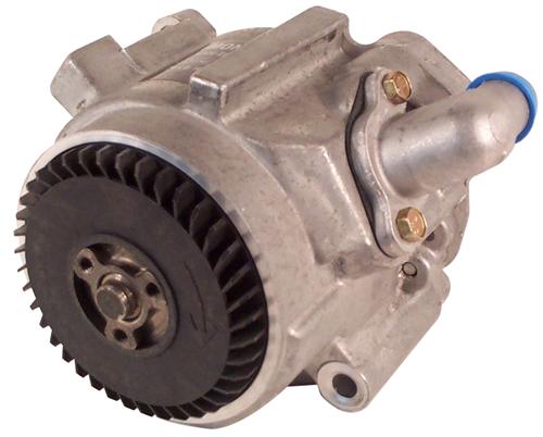

When I bought my car the SMOG pump pulley was all chewed up from the accident it was in, so I pulled the old pulley off with vise grips. Is there any way to put the new pulley on without damaging it (any method other than holding it with vice grips)?

Do get smog checked in CT? If you don't then you can remove the smog pump and all of the lines with it. then get a shorter belt.
Even if you do get smogged you could pull off the pump and lines. The only thing it does is help heat up the cats at first start.
Does your smog pmp still turn freely?
I'll look at mine tonight when I get home to see if I can remember how I the pully comes off. It's been about 3-4 years since I replaced mine.

So why can't you just bolt the smog pulley on?
They pulley just bolts to the 3 threaded holes.

I know how it attaches but I can't get the bolts too tight because I can only hold the pulley with my hand. Unless they don't have to be too tight, but the ones on the old one where on there really good...

Is the pump on or off the car? Using an impact will get the bolts to set but not sure if you have room with it still on the car

The pulley has to be off to get to the too bolt. Pretty stupid. Had to take the old pulley off while on the car, pulled the pump, and had my accessory bracket glass blasted and cleared. I still can't get the pump to line up with the top bolt again but I only spent like half an hour trying and then I just gave up. But I need to get that top bolt tightened before I put the pulley back on.
