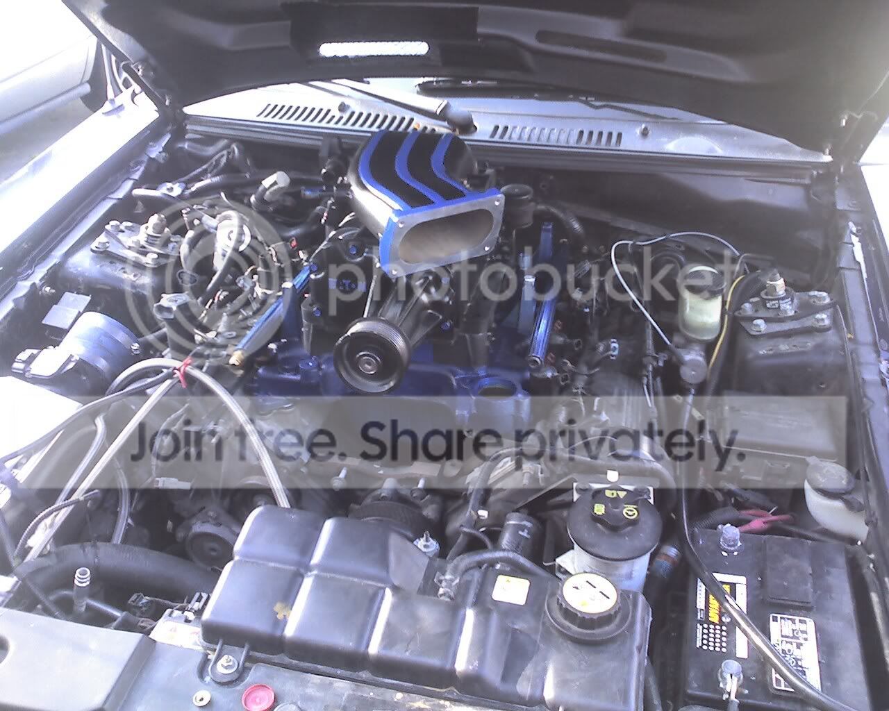

I seen it done in your car witha 6 inch pin on and the guy still had to make a little cut to clear the very top of the plenum.
BtW Its looking good im not a fan of how its painted but it still looks good either way.
Are you going to run the stock lighting crank pully? And if you need a intake elbow i have the stock lighting one im not using just let me know.
What are you going to do about the fuel rail brackets? I ended up buying the lightning specific rails and they work great.
Here is a pic of mine a week or so ago.I dont have a recent pic but the hole is a tad bigger and the air intake tube etc is on now.
Just have to order some -8 braided line and im going with black anodised summit fittings.And a nice fuel regulator and im going ot be close to Done

If all you realy want is the shape i could lay somthing on the inside of my hood and trace it out, i have the peice i cut out but i had to shave a little off after the the first cut out and i kinda free handed the sport for the CAI. i can get you a updated picture and show you what the hole looks like now with the CAI installed.Only thing i did on mine that i did not like is a cut out a little more then i needed in from of the blower pully.
Check out RPM Outlet i got there Lightinng Gen X Big Bore 5/8 Rails for $92 Shipped

I did not see this untill just now.Shoot me a PM When you get back on.The more i look at it idk if you can use my genral shape i have cutout.I had to take more out of the hood this past weekend and i actually cut out part of the scoop.
Since our hoods are so much diffrent i think there are some things i have cut out that you might not have to.Are you going to keep that cobra r type hood you have?
