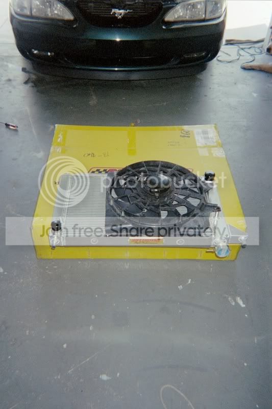

You are also using a ZAP radiator, if I remember correctly? I haven't been on track since my new radiator setup, I'm concerned I'm going to peg 250* and beyond in a session.

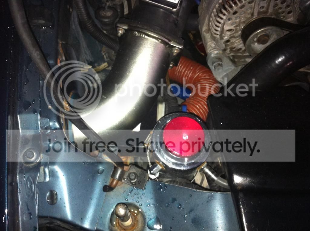

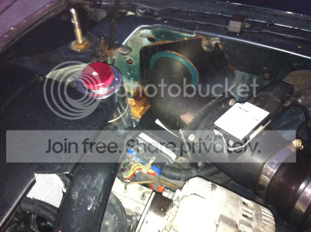

Where did you end up moving the overflow bottle to, and did you keep the stock bottle or switch to an aftermarket bottle? Do you still use the stock cap that has the sensor in it to warn for low coolant?
I switched to the aftermarket bottle and it was mounted on the side of the radiator right where the cap is. I'll take a picture of it later. I don't have the low coolant sensor anymore. I just check it ever now and again. This is not my daily, so it's easier for me to keep track of things like that.

Pics would be appreciated :) I'm considering moving the battery to the rear, and putting an overflow bottle in that spot.

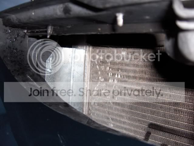

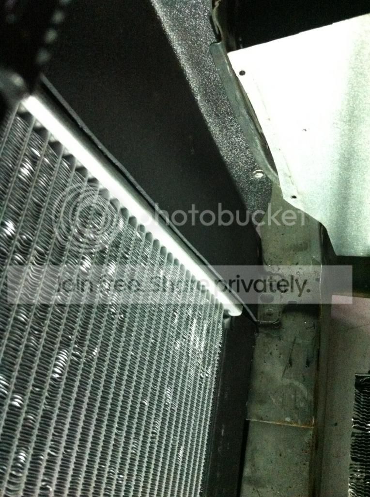

hotmustang95
Apr 6, 2011
611
27
Boynton Beach FL

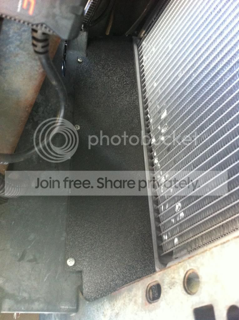

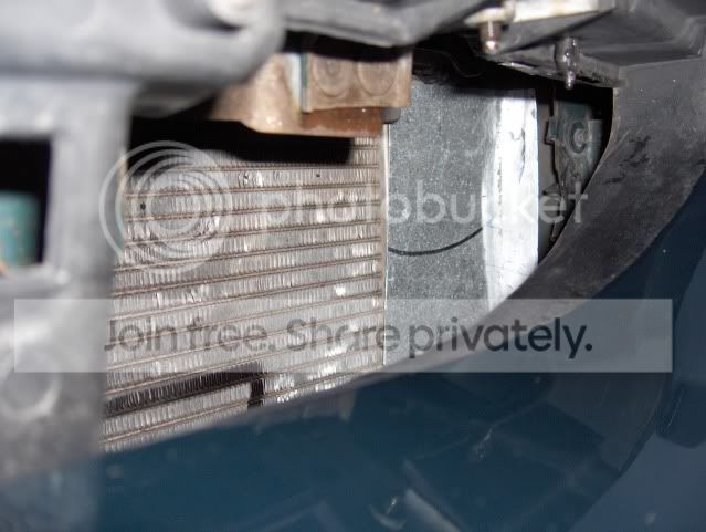

Boxing in the Rad
I loooove pictures. That's why I take so many. I need pics to see how things work so I in turn provide many pics of my projects to help people like me out.
Loooong story short. I fought cooling issues for years. Situation gets worse when your a track addict like myself so I spent about two years of testing different combos for the best results.
1: Like mentioned above, the fan is just for when the car is stationary. Anything over around 40mph and your radiator has more air passing through it then the fan could ever pull so forcing as much air through the radiator is the key. That's where boxing in your rad comes into play. Sure the car comes with factory stuff but it's not the best being it's very soft and old by now so it's brittle and breaks easily. You can use very thin sheetmetal like I once had. Some cheap metal snips is all that's needed to cut it. I used self tapping screws to secure it.
Another material that's great to use is ABS plastic. You can heat the plastic with a torch and bend it to your liking.

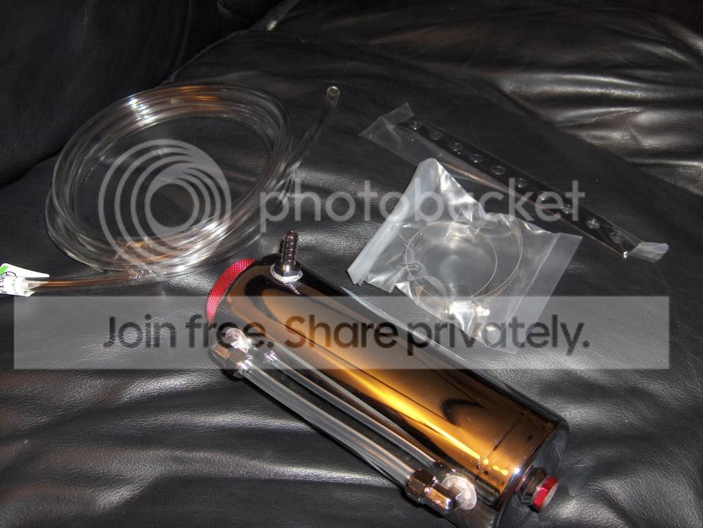

Aftermarket Overflow Can
IMO tricks that work good on a racetrack will certainly work well on the street. Cooling for example. If you can figure out a way to keep your car cool during a 30 minute track session, in May, in South FL, then street use isn't even a concern. Now every car is different so one thing that works for one guy may not work for another but everyone knows that getting as much air through the rad as possible is what keeps the car cool. Once you've boxed that rad in and forced all the air into it, it need to easily pass through. I found that removing the shroud allows more air through. When the shroud is in place the incoming air can only pass through or funnel trough the area of the fan. To do this you also have to move the overflow tank out of the way. My car is a 95 so the tank site to the pass side of the car right next to the fan. It's also a big tank. I bought a new universal overflow bottle from Murray's but I believe you can get one from Summit, and placed it in the area of where the intake filter box used to be. I have a CAI now. I also relocated the CCRM to the area where the filter box once was. The CCRM comes from the factory attached to the bracket that holds the stock overflow bottle. Doing this opens up that entire area in the rad allowing easy flow of air through the rad at speeds. I don't have any current pics of how it looks like today but I'll take some tomorrow and add them. Below are pics of the cut up fan and the new bottle.

Thanks for the replies, [MENTION=15115]hotmustang95[/MENTION]. I've got some ideas now about how I'm planning on addressing this and reading about your experiences helps, thanks! A couple questions: I am planning on boxing the rad, I've got some aluminum for this. I notice that you completely blocked off the bottom of the rad. The car is originally designed to suck up a lot of air from the bottom - why did you choose to box off that area as well rather than just the top and sides?
