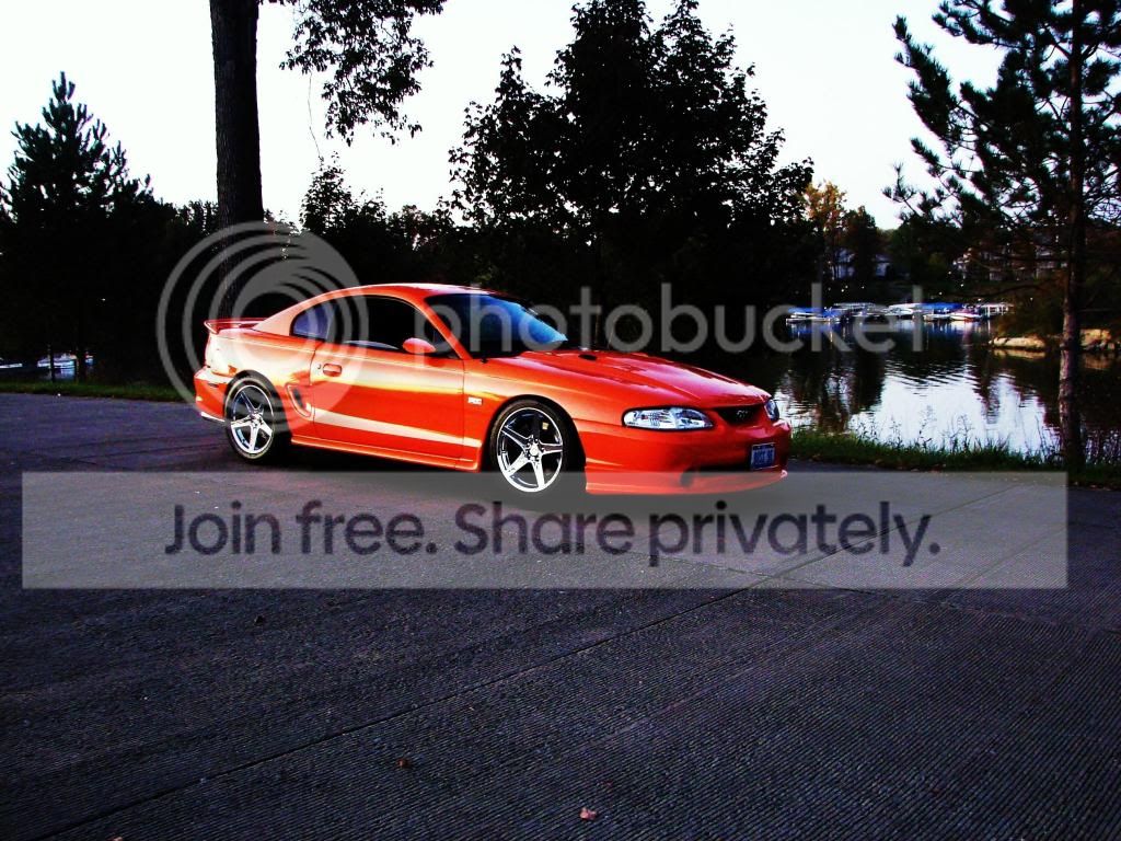

i made a rendering of what id like to have my car look like by spring.
What do you think? Too much ?
I will be trimming off the lip of a set of termi mirrors.......
as well as sportline springs with no isos

i like it :) good tasteful choice, i want my car to be that low, but i like where it is becuase i dont hit every germ when i drive lol :p but its my DD so maybe when im not driving it everyday i will do it

when you drop it that low you're going to have have multiple clearance issues. for one you're going to have to modify your inner fender wells so they don't rub as well as roll your fenders so it doesn't cut on the lip. I know this because I had to do it...
Just some things to think about. And since you said you mentioned a k-member before at least you won't have to worry about the suspension geometry being retarded.

I like it. Im thinking Im gonna put the lower isos back in in the rear of mine.

What kinda mods to the wells brett? Trimming I assume. Rolling I don't have an issue with thoughAnd since I'm not running smoked tails or black bezels, I loveee the chrome haha

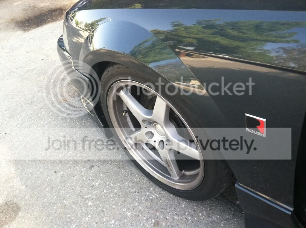

Like so:
I cut out the areas of contact because it was definitely screeching over any severe bumps. I also hammered in the seam weld on the chassis because it was protruding where I cut out the fender well cover.

^damn i dont have any of those problems, guess I need to go lower.
Your plan looks perfect man, if I had an orange stang, i'd want it to look damn close to yours!

I didn't really even mean to go this low lol. after I dialed in the alignment I actually lost a little bit of ride height.
I can barely fit 2 fingers under the front bumper lol.

That's an awesome stance. Props if you can drive in your area with that. I definitely can't. I scrap and that's just with my current set up on NYC pot holes/bumps and a bunch of driveways when I'm not paying attention.
