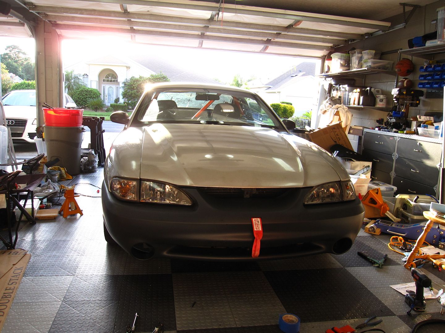

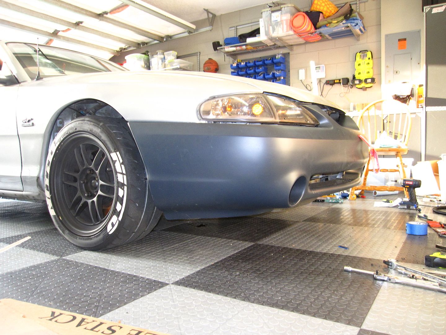

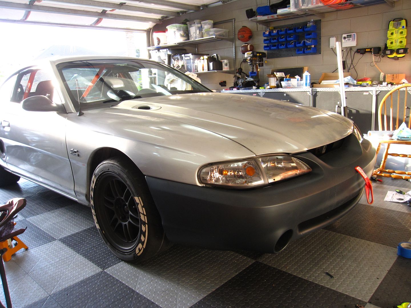

Since I got around to installing my aftermarket Cobra bumper, I figured I'd bump this thread for reference.
Pics of it:
That bumper is from LMR, and it's a urethane one. I will say, I am quite happy with the fit. It looks damn good at the fenders. Lines up very well. My only gripe (and it's a small one for me personally, as I don't really care about it) is that the gap between the hood and where the headlight section of the bumper (where it attaches to the top of the headlight support) is a bit big. But it's really not that bad, and the car's body panels, I'm sure, aren't lined up the best any way. So for me, I don't really care.
But otherwise, it fits great, and is very pliable and flexible. Well worth the cost over a plastic/fiberglass one. Honestly, I'd even go as far as saying it fits as well as OEM. I'm pretty sure my OEM bumper had some weird gaps here and there.
