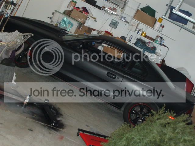

Can I use this palm sander,
With this grit
to take off this spray paint, paintjob?

Well me and my uncle, who is a body man are supposed to do the body work and prep,then im gonna have the maaco near me paint it....(its a really good maaco, I've seen some of their work on the local forum) but I dont understand the first part of your question... Once its removed its just gonna be the stock paint underneath it, do i need to sand that with a higher grit?, because I've got all the way up to 2000 grit.

No but really just take your time and don't apply too much pressure when your sanding . Let the machine do a good bit of the work and if your unsure of spots do those by hand. You'll be fine. I am masking off my garage and buying a sprayer and paint and doing mine this summer once it warms up. I think Jason (vermillion) is going to visit with his car also. :)
