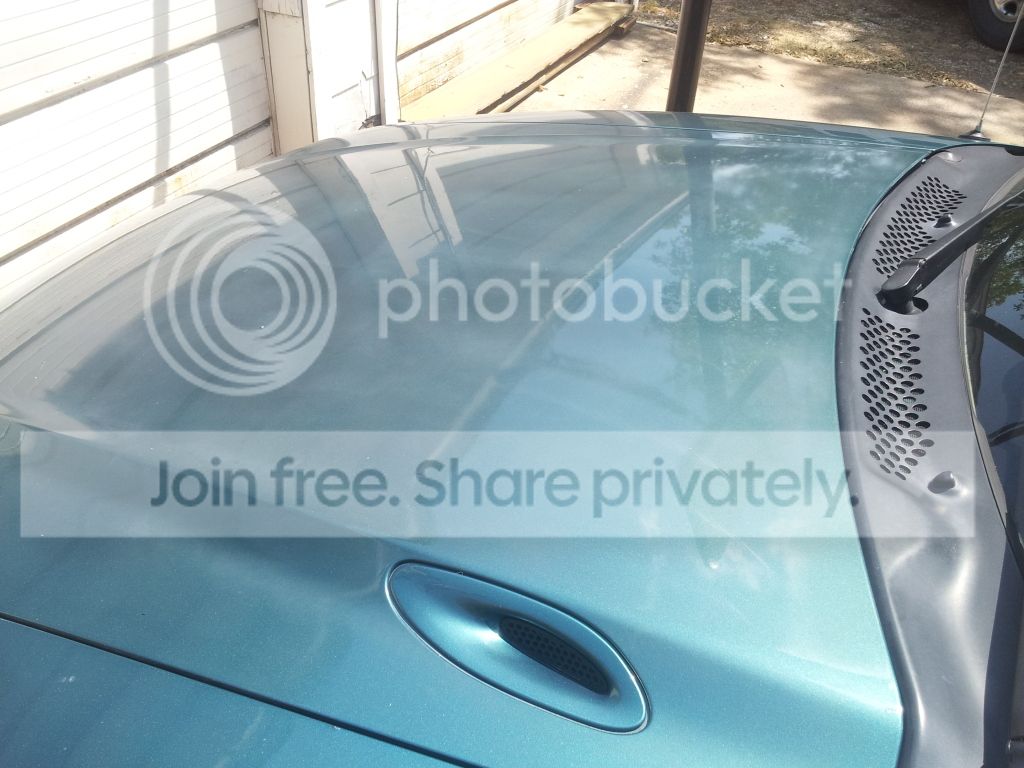

how do chemicals take out scratches? please explain.
images
If a scratch is not so deep then yes it can be taken out withe the correct materials, Ever look at your car in the sun light and notice all the spiderweb scratches from drying it off over the years or maybe from the previous owner? Those are scratches and can be removed.. My car was covered in them when I got it and took it to a guy's house where we spent 8 hours buffing the entire car with a D/A he did the driver side and I did the passenger side. Once we were done the paint looked as though it just got a fresh paint job. So yes scratches can be removed depending on how deep they are, if they are too deep to be removed where it has damaged the clear coat then yes they can be covered as well but will eventually show back up within time.
sn95jones
May 29, 2011
4,139
323
Arlington, Tx
I shouldn't have to tell you how if you obviously know how, if you don't think it's possible then that's your opinion but I've seen it first hand so I know from experience that it can be done so whether or not you believe me or not I really don't care, but don't sit there and call me a liar when I've done it myself...
By the way here's what I used:
http://www.autogeek.net/poorboys-black-hole-show-glaze.html
http://www.autogeek.net/poorboys-world-pro-polish-2.html
http://www.autogeek.net/nattys-blue.html
http://www.autogeek.net/pbqd16.html
and then two of these
http://www.autogeek.net/dewalt-dwp849x-polisher.html
I'm sure I'm leaving out 1 or 2 chemicals that were used
