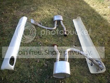

hahah thanks. i think the big thing is the standard side exhaust kits use a same side in/out muffler. mine doesn't.
borla and traditional kits:
mine and riosnake's design:
not the best picture but you get the idea. comes off the headers to an x-pipe then to straight-through mufflers, then right out to tips. pretty much zero obstructions
