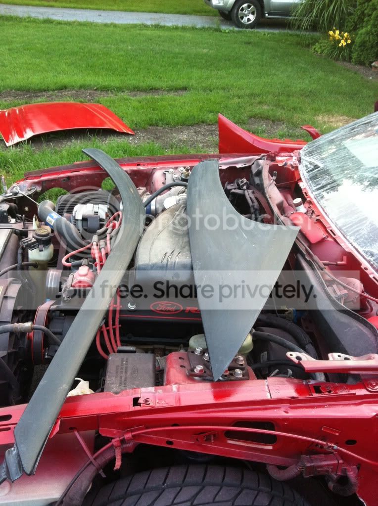

Roof, rear sail panels, and left rear quarter done:

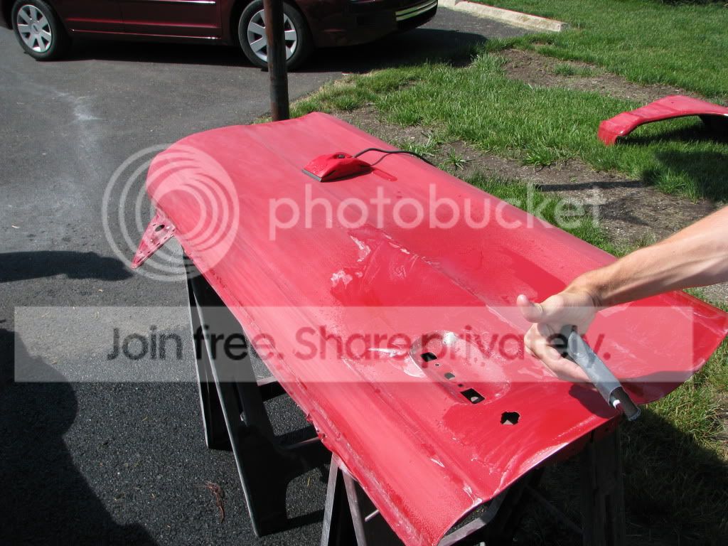

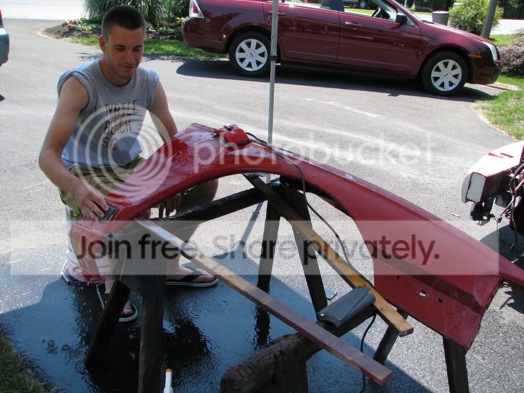

Yeah, I sanded that sail panel. Get some:
The mustang crew pitching in. Left: the owner himself. Right: owner of a 95 that is totally ripped apart and doing a ton of body work. Back: owner of a 97 Cobra with a Vortech. Mmm.

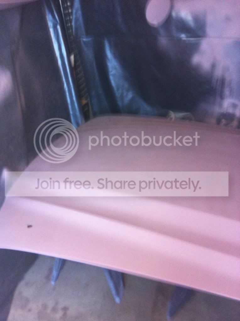

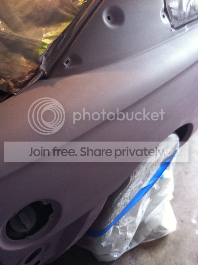

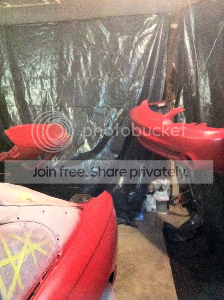

PPG NCP250 prime its purple!! excellent prime. stuffs expensive though 55 dollars a quart!

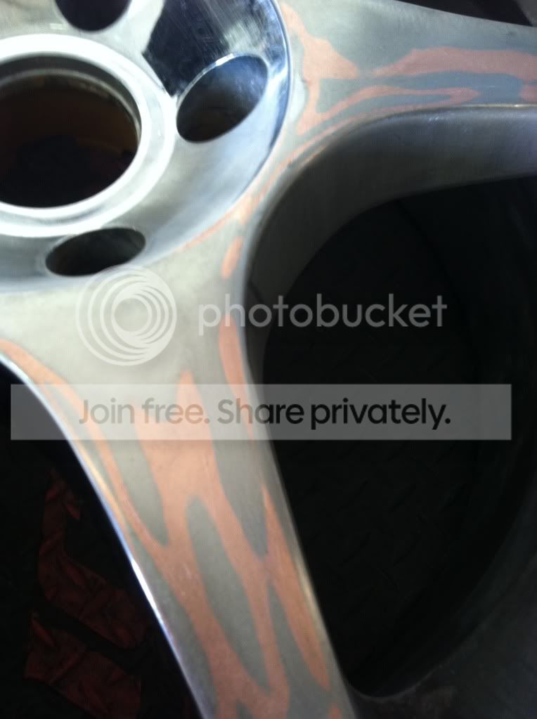

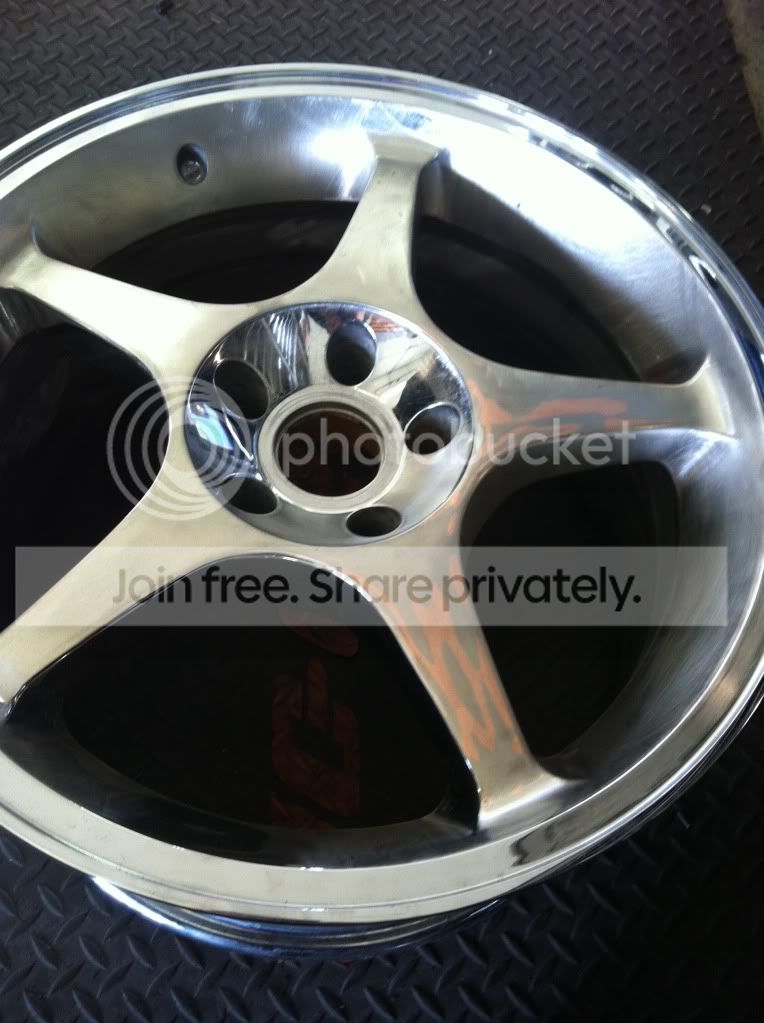

my chrome was pitting soooo

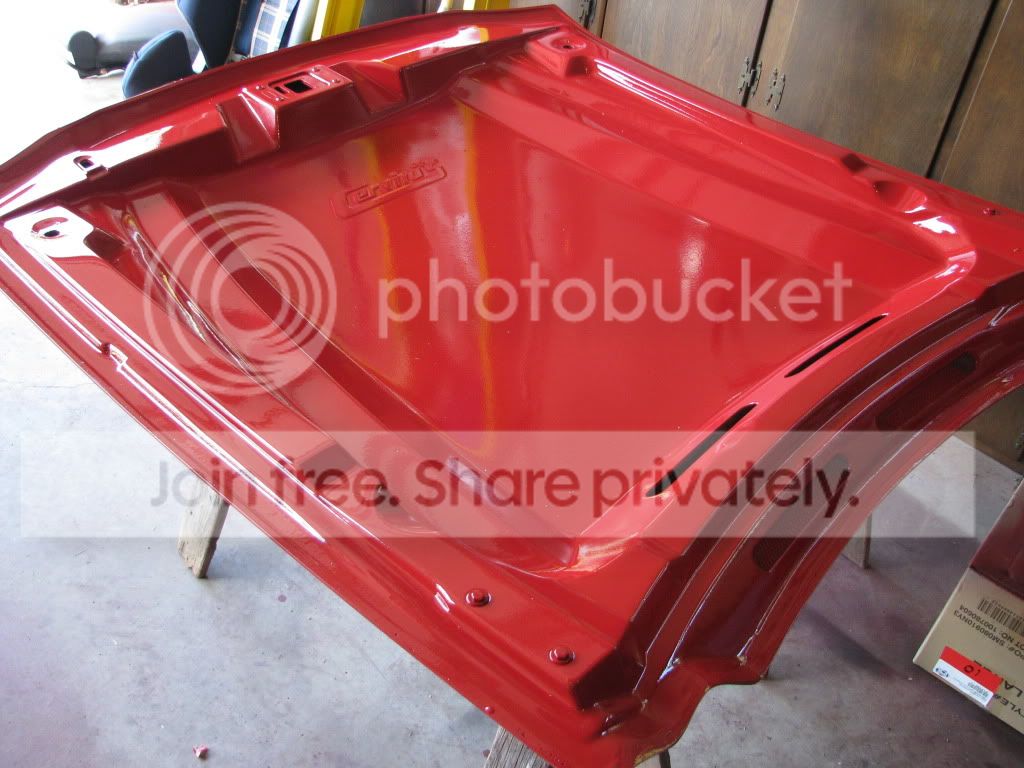

custome red paint!
thats all for now. i have a sinking feeling this piece of computer is about to explode!

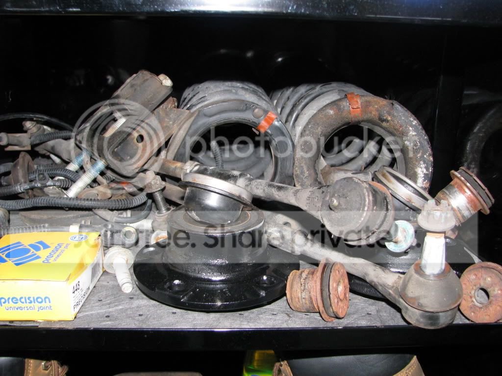

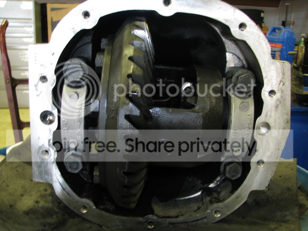

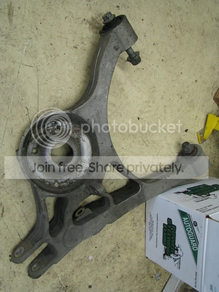

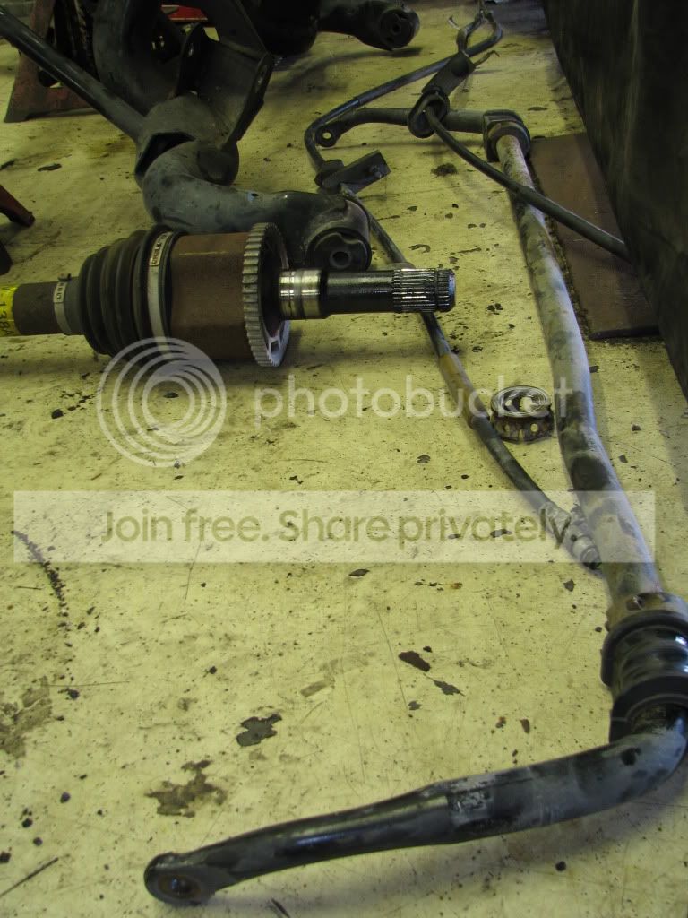

As you can see, the IRS is totally stripped apart.
Monsterous axles:
Might get rebuilt, might not?:
These are getting rebuilt:
Some random pieces tucked away:
Stock Bilsteins for sale:
Here's some pictures regarding the special u-joint. The IRS didn't come with the yoke so this is a new Cobra yoke:
Here's just the u-joint:

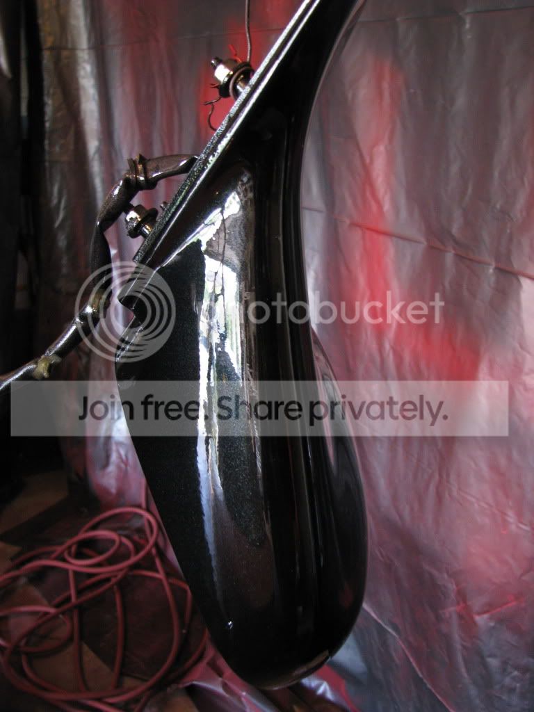

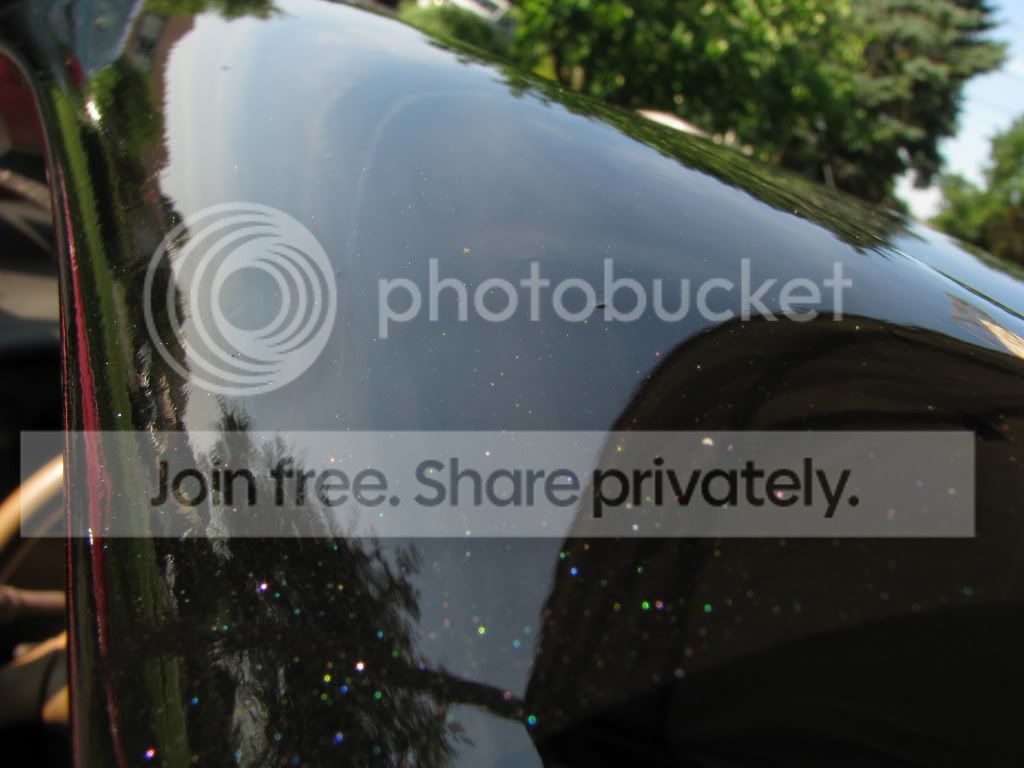

roof after the first buff. notice the reflection! looks nice

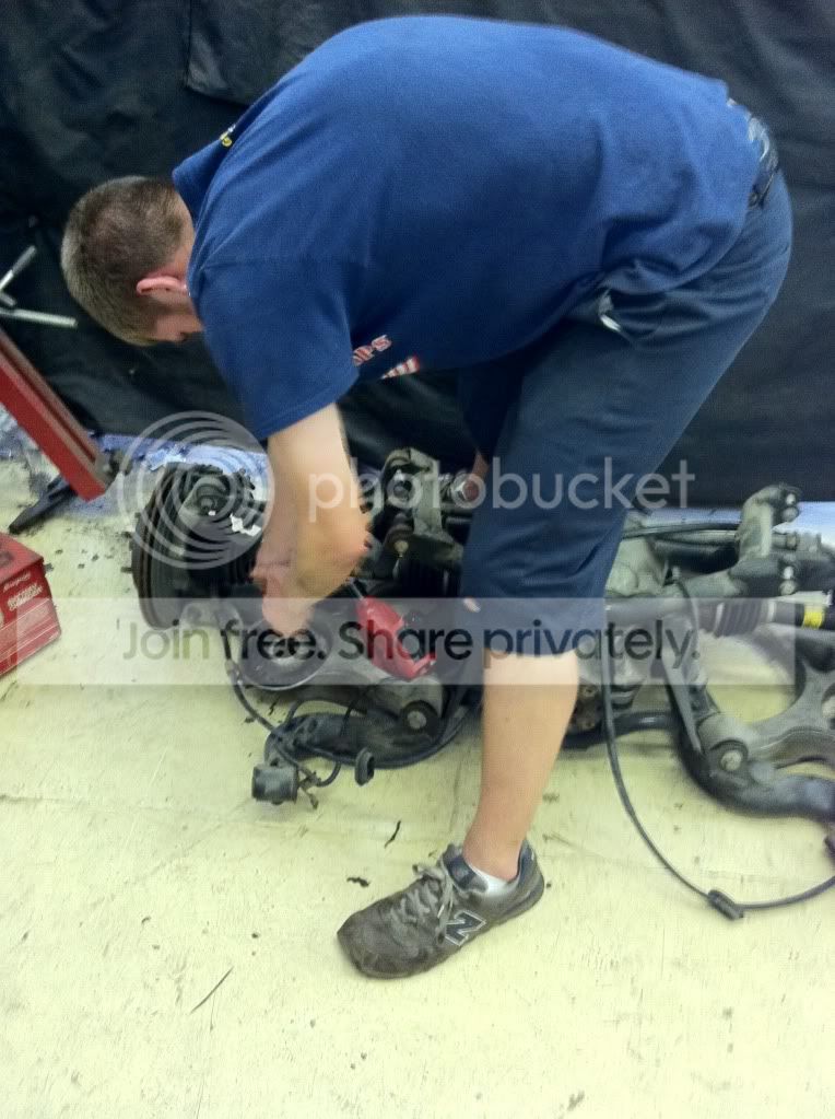

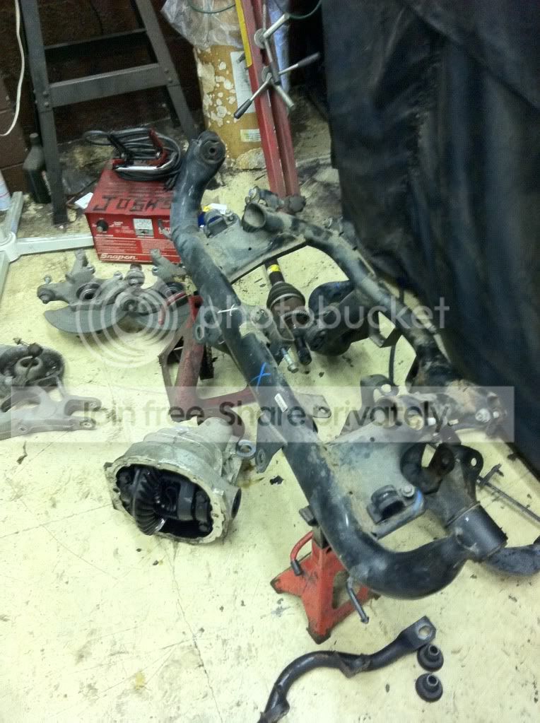

Willy starting with the IRS tear down

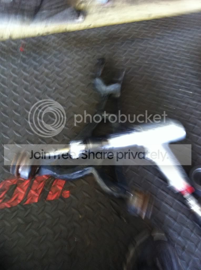

removing the crappy stock upper control arm bushings
hopefully no wheel hop after this. planning on the maximum motorsports kit.gonna be doing some clear coating later tonight and got a big work day saturday so wildWillyWalker or i will have some new pics up

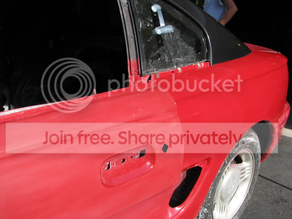

The quarter is totally done and buffed but the door needs buffed. Quite a difference:
Smitty ran out of paint so a paint shop took a picture of the sail panel but they didn't do such a great job. The darker panel was their attempt. Not even close:
It is a sick black though. I believe it's Tuxedo black from Ford?:

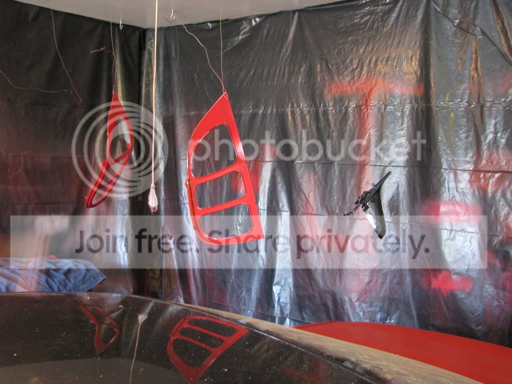

Close up of the finished product:
Light covers to match:
Some work, some don't:
