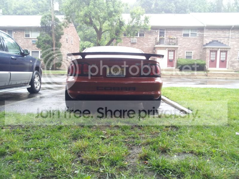

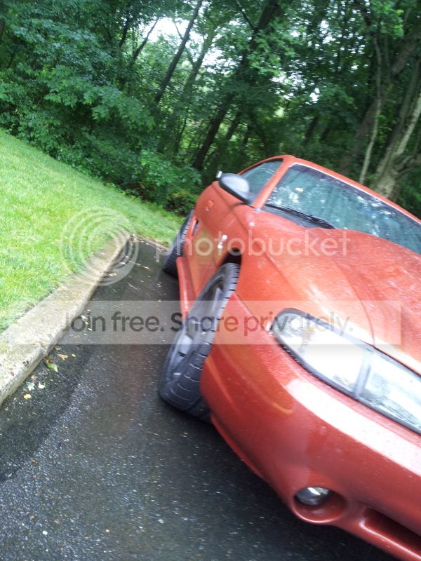

I am also running 1.25 Hubcentric(please for the love of god make sure they are hubcentric) with 295s and have had no problem. They have been auto-xed on and everything.. Well when I had 275s anyway... not with the new 295s..
Either way they hold up fine and really fill up the wheel well..
best pics I have. so hope they give you an idea.. btw 1.25s with 275s fill the wells perfectly.. the 295s.. stick out a tiny tiny bit lol
