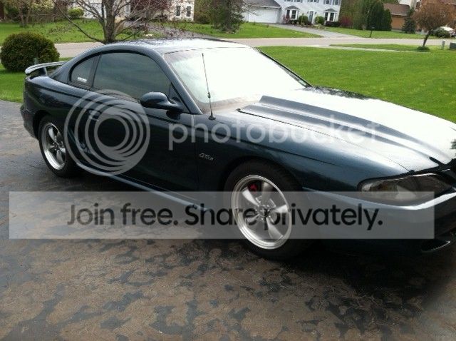

I got the car back from the Trans shop, and they did a real nice job. I finally decided to do the PI SWAP. I completed the swap in early November of 2012, and I now have about 20 miles on it since the project. I am hoping in the spring to have the car tuned again by Adam.
Latest picture
