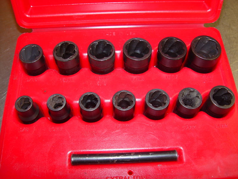

You need to go to the tool store and pick up a set of these sockets that are specially made to remove rounded bolts. I have these sockets and they work good.
