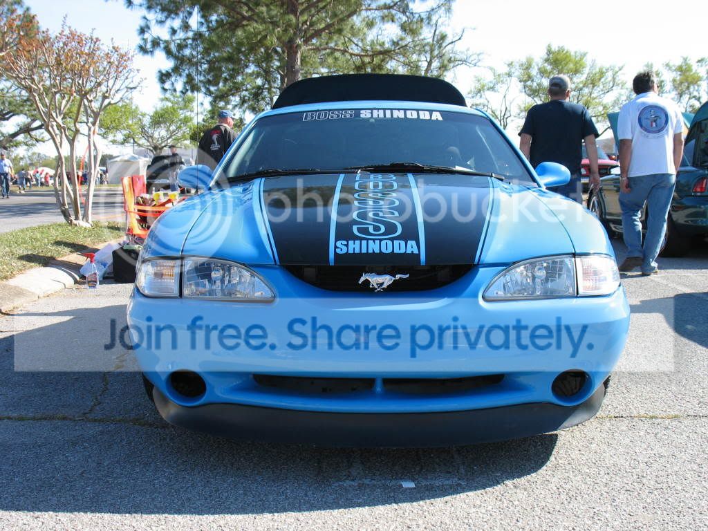

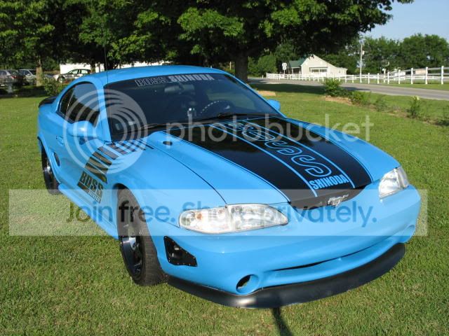

here is a picture (and theres not many out on the interweb) of a boss shinoda cobra with the cobra splitter

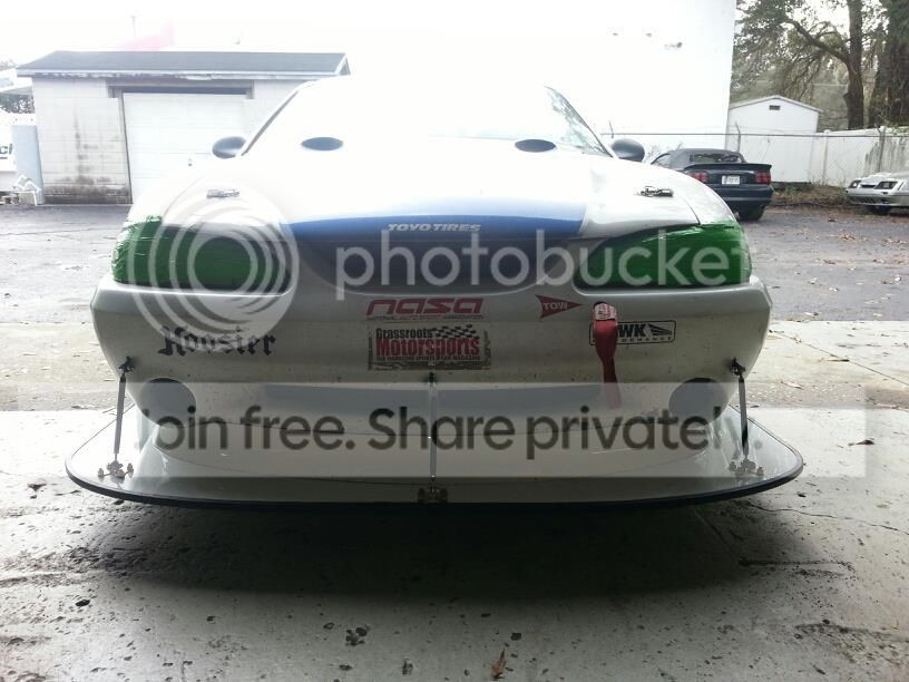

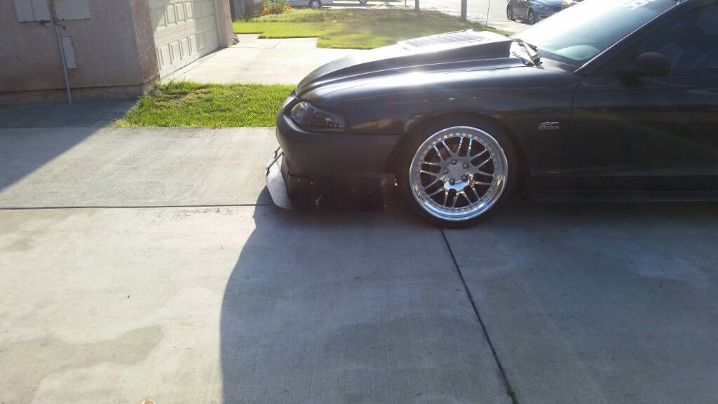

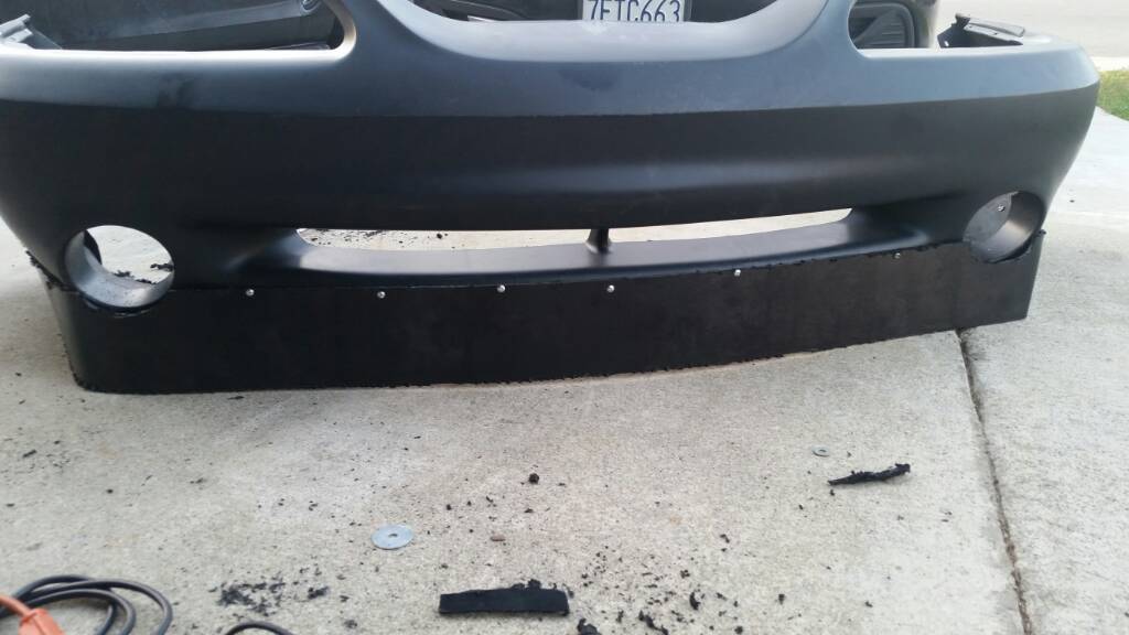

Do you want function or do you want looks? or both? Because there is a ton different ways to do so. Personally not a fan of the shinoda spoiler, but thats just me. I did the splitter designs a few different ways. everything something happened to it, i had to come up with different ways to design and mount. The first thing you gotta do is find out how to make that splitter leveled, because the bumper are not flat, which is the reason Ferocious used the mach 1 chin, and reason i just got a long piece of ABS and bolted it onto my bumper. I tried to make it even all around. but the fact is that the front of the splitter needs to have just the right downward angle to the rear, meaning the front is lower then the rear of the splitter.

If you look at my build thread youll see the different designs ive gone through. Here's the current setup. I try to be as descriptive as possible but if you have specific questions let me know. I can help as much as i can.

Well the shape of the splitter isnt going to affect function. Thats all preference. And if you like the shinoda chin, then by all means use it. Its another thing thats preference. Just so you know the chin is just that. Its a piece of plastic thats form in a way to reflect the chin of the bumper. Now as far as function. Thats going to be determined on how you mount it which will stabilize it. My first splitter was cut, so it didnt extend all the way past the bumper to the k-member. Second splitter stopped at the bumper but since it wasnt secured, when i kit 75 it would rattle the whole front end and make scary noises. So i ended up making some holes in the rear and zip tying the rear of the splitter to the sway bar. Also that splitter was bigger so the sides needed additional rods for support. I hit a puthole as i was leaving from a dead stop and it cracked my bumper and splitter. So too avoid that again i have no attachment to the bumper. Im working all its kinks as they come.

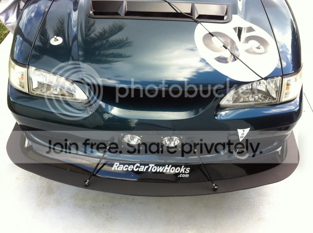

If i had to do it all over again, i would start was a larger piece of whatever material i am going to use. use all of the mounting that i was going to use, make sure it won't shift. So you would need to engineering it for those bending points, or use extremely stuff mounting rods or brackets. and do what this guy did. there you would have the perfect shape, and the mounting just right. All you will need to do is mess with angle to get it right. just my $0.02. And i am probably going to do that soon after my autocross date. The splitter i have now is all jacked up.

well fiberglass isnt necessarily a bad thing. it depends on how you wanted to mount the splitter. fiberglass is pretty stiff so it will have a good based, however, if you wanted to mount the splitter to the chin, i can see how that can be a problem and causing it to crack. depends how you drill the glass and how good it was laid.
