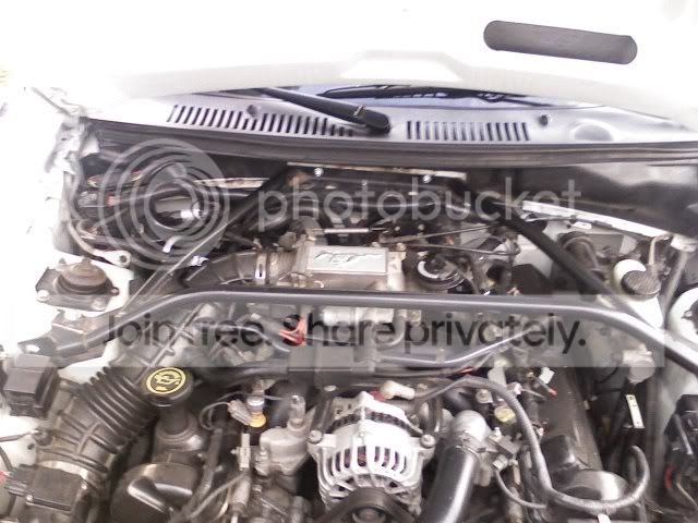

well my friend and I installed it yesterday.
Went pretty easily, although we went through 3 drills and a couple trips to lowes to get washers. i think it turned out pretty good. Made a hell of a difference too, I was amazed...and for free i can't beat it :dancing6:
again this is a 94 GT stock strut tower brace on a 2000 GT
-Pat
27,321
K, ill shut up now. :eek:uttahere:
the CAI tube looks like its pretty close to the brace.
Goldmember
Aug 27, 2007
3,110
77
Cornwall, NY
thats the factory tube... since its a 94-95 brace it's meant to clear the 5.0 intake, idk if the design of the brace changed for the 96-97 cars though.
