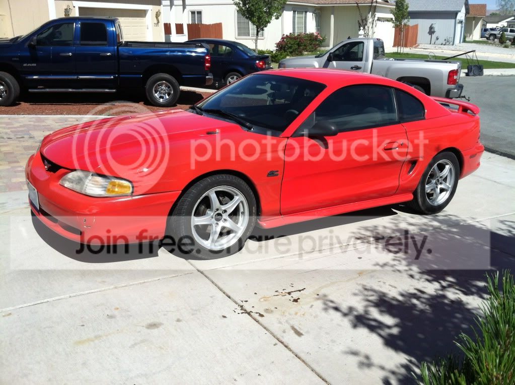

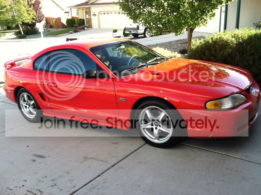

mustngsally88
Jul 1, 2012
26
Here is pics. I was gunna pull isolators out. How much will that help if i pull tops and bottoms all around? im running 17 cobra r's

it will drop it roughly 1/4 to 1/2" ... maybe.
I suggest just getting new springs and selling your old ones.
i personally like the stance of your car, but its not my car. lol. So, if you have some spare time, drop the ISOs. they arent that big of a deal, but still kind of a paint in the ass for a 1/4" drop...

Great looking SN.
I like is as is too. Agree with springs, get some that will give more of a drop.
