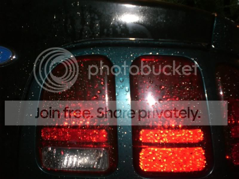

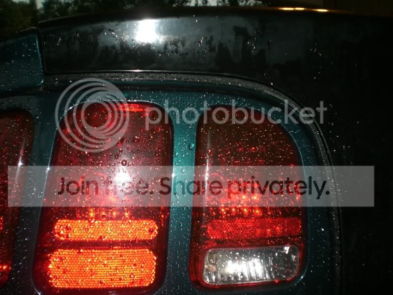

ok so i switched trucks with a guy who had a 6 cylinder no button to release trunk. Now my trunk wont pop open did i have to switch th ewiring harness also. And one more thing this is the 3rd trunk deck i had on the car and the trunk never fit perfect but never this bad.
Driver side see the gap
Passenger side much better
Now my trunk is all wet but never had that problem before. is there a way to adjust the trunk?
