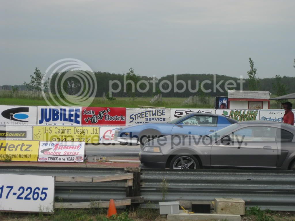

Well, went to the track yesterday, lots of BS happened, only got 2 full runs in which sucked BIG time, but things happened lol. Ran a personal best of [email protected] with a 1.69 sixty, got to aggressive, tried a 5.5k launch on a prepped track on a stock rear end, here are the pics ;). Will have video of blow up later!
