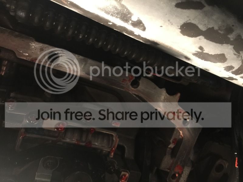

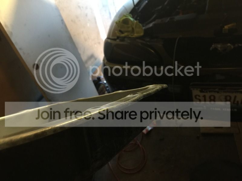

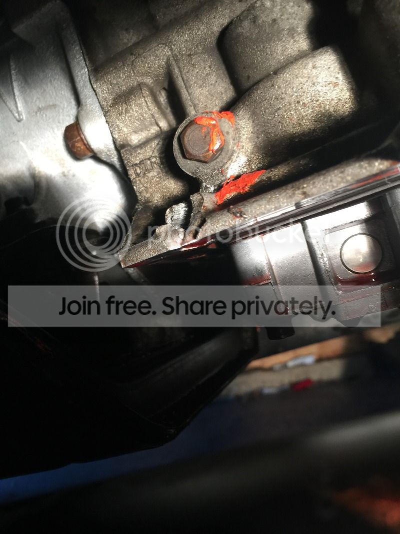

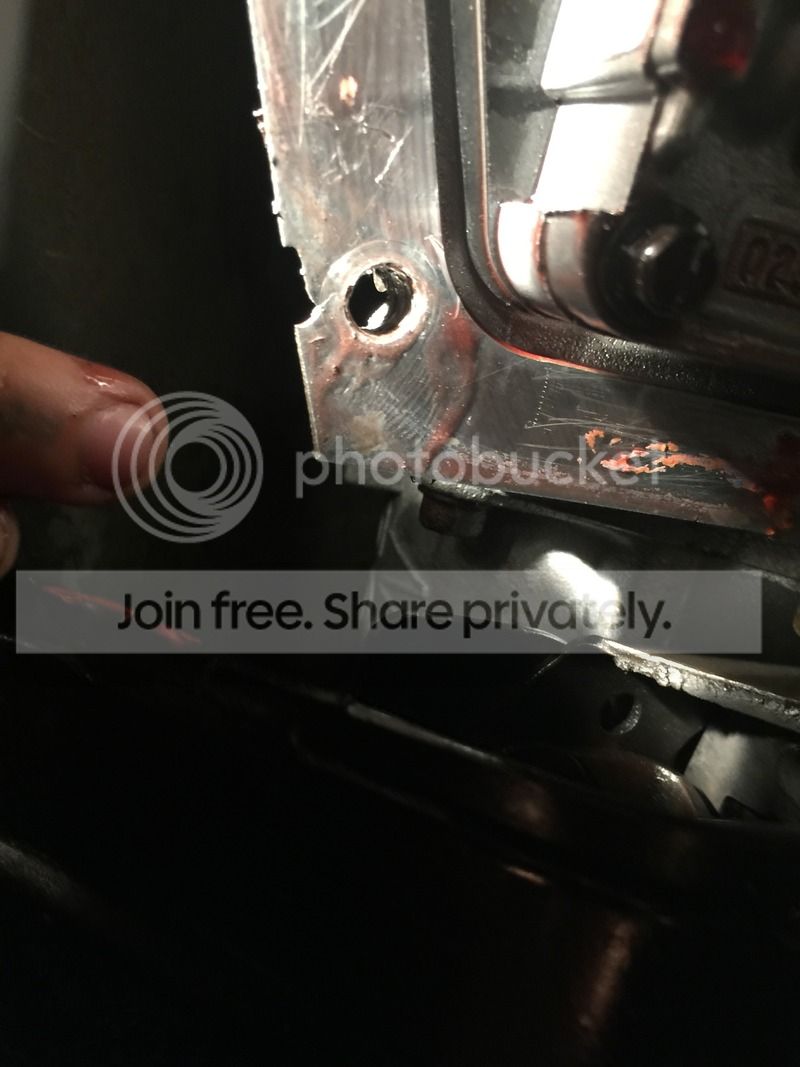

Hey fellas, this is my first post, too bad is a question lol.
The thing is that i took off my pan to replace a solenoid but when I placed the pan back the bolts struggled with the damn gasket so i pressed more than i had to and i stripped some bolts, so i had to step to size 10 but while i was re threading this two spots broke and fell. i put rtv and the gasket, but it leaked, buyt the gasket was defective so i dont know which one was the reason. Im thinking to use permatex without a gasket. What you guys think, would it work? Im trying to avoid trans replacement cause my internals are on great shape and i dont have enough money to buy a built one.
Thanks in advance fellas, im also attaching some pan pics.

Wow man. This is bad. At this point you would be rigging it up regardless and hope and pray it doesn't leak. Slow leaks kill transmissions. You could try a nice thick bead of RTV all the way around it. Make sure both surfaces are clean and dry and follow the instructions on the package to the T. I've sealed up some stubborn trans pans and oil pans like this. Good luck though, I hope it works out.

Hey bro, yeeaah i know, i can't believe it happened, i wanted to hit myself. I just cleaned everything and did a thick bead of right stuff but im not sure if it was enough, I didn't wanted to get to much on the inside . it did squeezed out when i torqued the bolts but not as uniform as i wanted, so what im planning is to clean all the edges and apply ultra black rtv as a second seal. Damn dude i hope i never have to take out that pan again lol.

If you end up not getting it to seal, there is a group of videos that show you how to tear down and rebuild the 4r70w/aode. It's not hard at all. You could swap you internals into a different case or buy another trans from the junkyard and rebuild it cheap and just replace yours.
