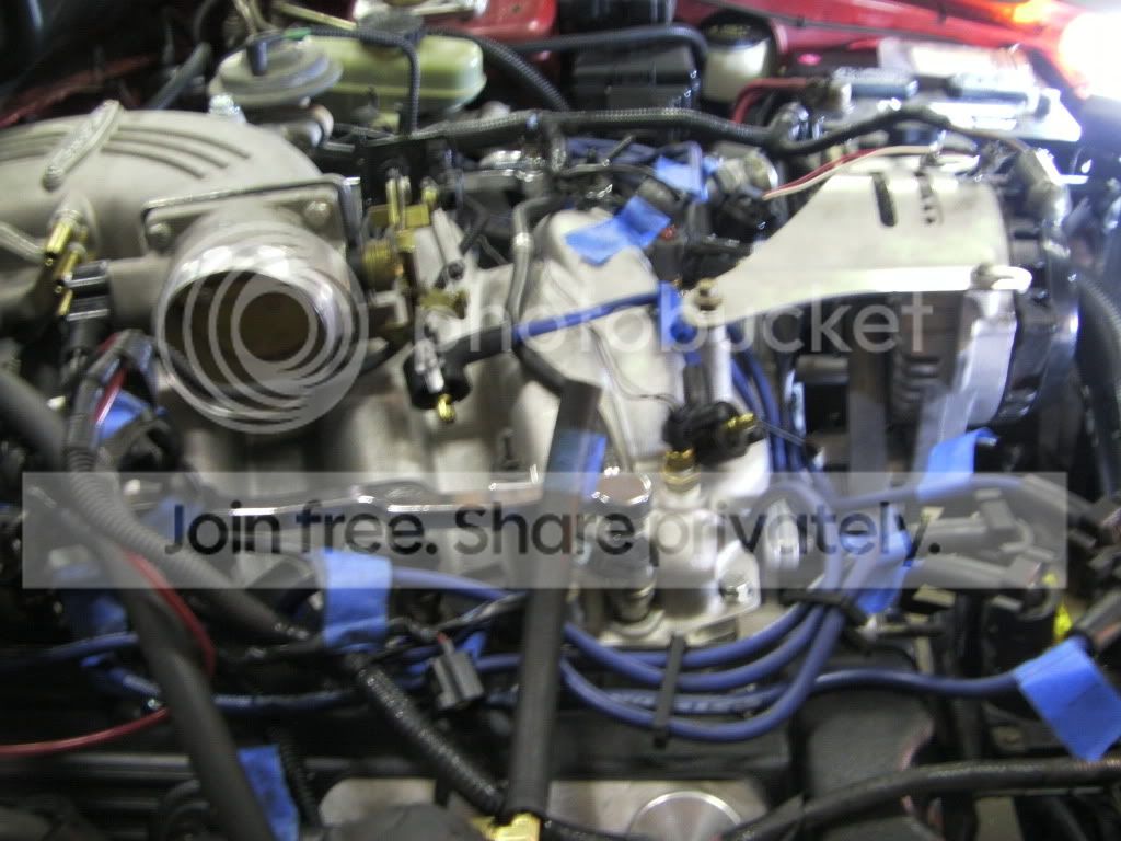

I am trying to figure out where to put the ignition coil...anyone cross this bridge?

why dont you try to move the PS resivior and then bolt the coil in the stock location....

The stock coil location is about 1" too high for the radiator line to pass. I'm looking at fabricating a bracket lower in the stock position or next to the passenger side coil. Thanks for the suggestions;) Duff, anyone else have this kit on a non-cop motor?

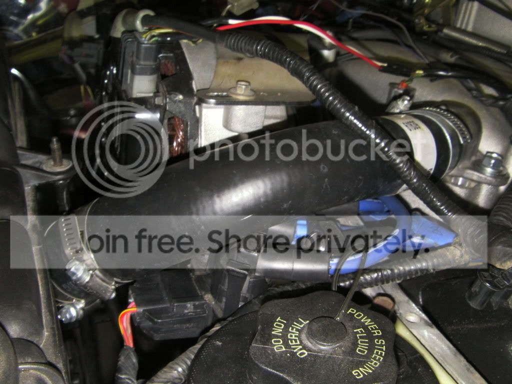

I cut the factory ears off and fabricated a steel mounting plate that lowered the coil pack about an inch.

While this solution will work, I would still consider mounting the driver's side coil pack next to the passenger side for more clearance.

nice fix. looks good.. just watch for rubbing on the top of the plug wire socket and rad hose. dont want to rub through the hose.
