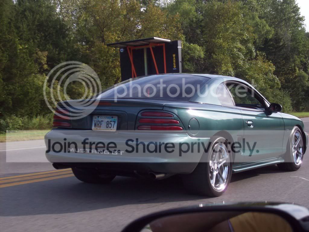

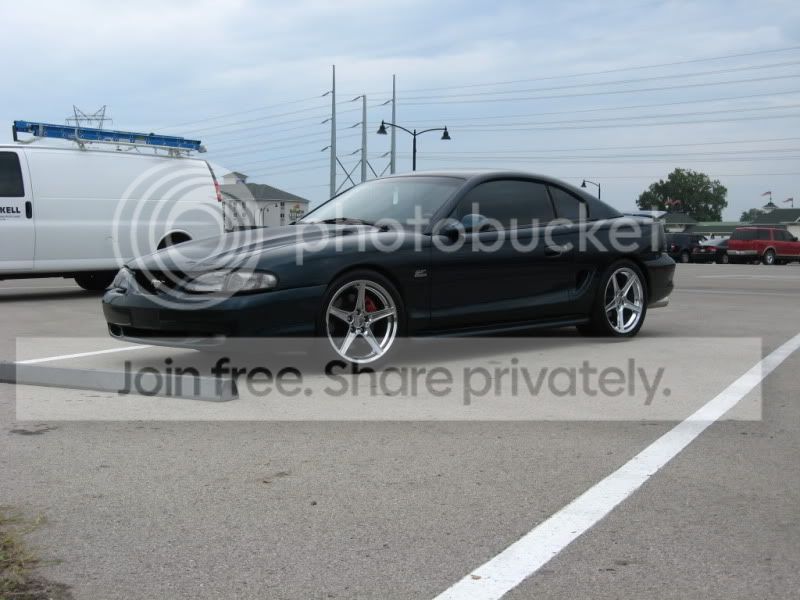

Here is a rough comparison between Sportlines and ProKit Eibachs....
Sportline springs (Javis car) look especially at the rear tire-to-fender gap
ProKit springs (my car). Ignore the front tires, way too tall of a tire.
bigkeeko
bigkeeko
Aug 3, 2010
361
Scotland
2slo95fiveoh.
Thanks man, thats the kinda info I was looking for. The new edges have HUGE fenderwells (arches to me, lol) and even the stock wheels look ridiculously small in there. I`ve saw S197s with bigger set ups and was just thinking I don`t want to splash out $1200 on rubber band tyres for rims to find theres still a huge ugly looking gap.
