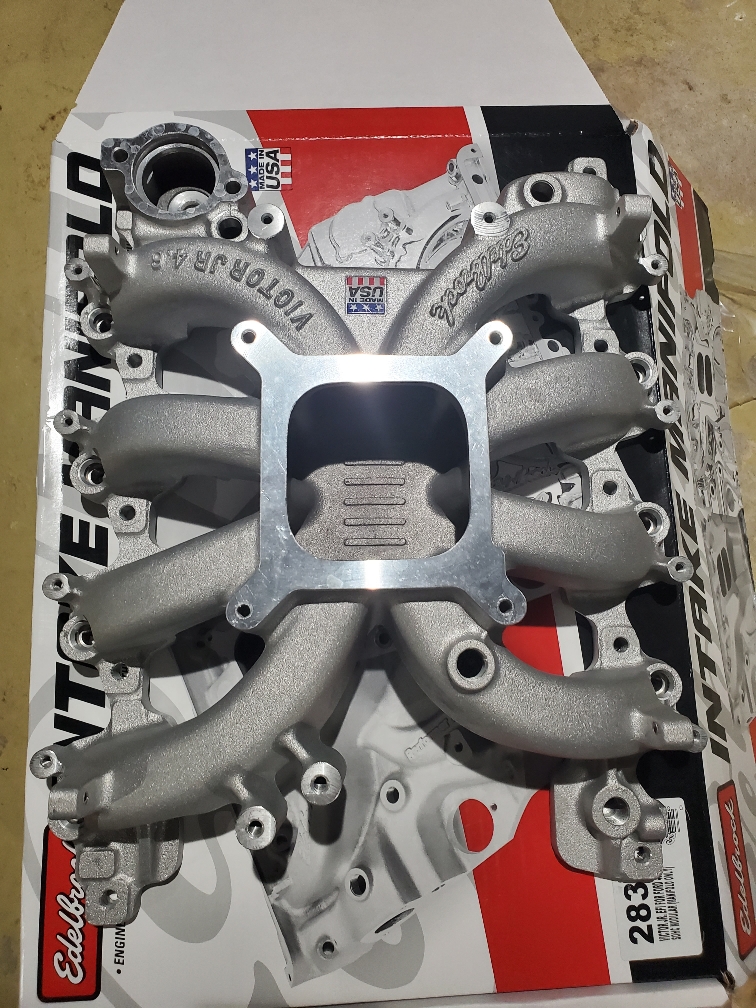

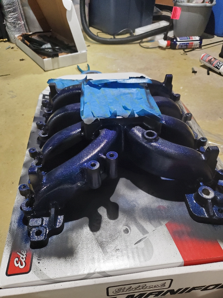

New victor jr intake manifold for my turbo 2vgonna match up pretty well. Can't wait to install this setup needed this since my new built engine and the stock Manifold cfm dies off around 5200 rpm

Yup! I can see why power gets robbed with that dorman intake! The eddy will allow whatever you put through it!
I use to mod the intake for stock fuel rails to bolt on. Paying another $200+ for the proper rails and hardware didnt sit with me.

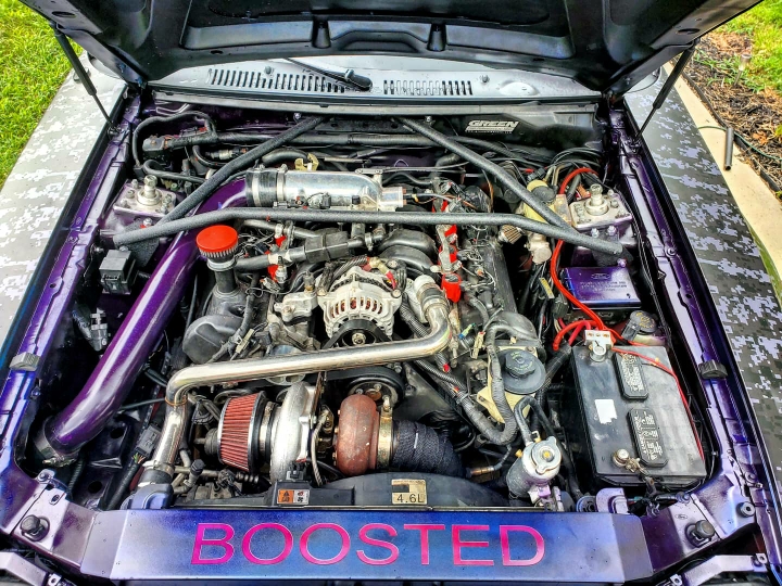

Yea agreed can't wait to put this all together and run this setup I love driving the stang and turbo but around 5k I can feel like the drop off

Honestly tho, i couldnt see a boosted intake of any type being a restriction at such low rpm. But high enough rpm for valve spring problems under boost.
Another thought and would be a cheap process, the lashers probably need to be bled out. They hold old oil, changing their character. Take'em out, heat them up, and squeeze work them clean. Do a good synthetic 5w-20 oil change while youre at.
My initial thought to this response is, valves are hanging open. Common problem with boost pressing on the valve, essentially reducing seating pressures.

Yup. Ive seen fully built engines produce 500hp when their purpose was 700hp. Threw a ton of money at it trying to figure it out. Finally, by shear luck, noticed valves not seating, after 3 tare downs(we learned alot from that truck)not noticing the valve situation...lashers were the problem. We shimmed check the valve to seat opening and it was .020" ....every valve.
Why did it run? ....normal operations will force the valves closed, but at the wrong time.
Swapped out the lashers, dyno'd 700rwhp.
Since every part was new, we came to the conclusion it was his break in oil used. It was specific high dollar break in oil from a big reputable name i will not disclose. And since my buddy buys nothing but the best due to his disposable cash flow, break in oil was the culprit.
Now dont think the use of break in oil are the only reason lashers goof up. Overdue oil changes, high milage, and heavier oil weights also cause this.
Just some ideas to crunch on. I want you to be as successful as you can be with your build.
