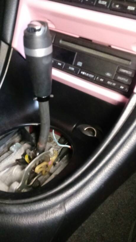

Ok, progress so far. Popped off bezel (reinstalled for the pics). Factory knob comes loose by loosening hex screw in back. 2 screws hold the PRNDL bezel. Cut cable tie holding OD wire. Pulled old knob off. New knob installs with three set screws that are too long and stick out - if I can't find shorter screws, I'll grind them down. The boot comes Tuesday, as will new pics. May put the PRNDL bezel back so the boot is captured between it and the outer bezel, don't know yet.

Got the boot in yesterday's mail, put it on. Looks SO much better! The job is done except for swapping the set screws with ones that don't make the knob look like Frankenstein's neck. Will post pics when the new set screws are on.
