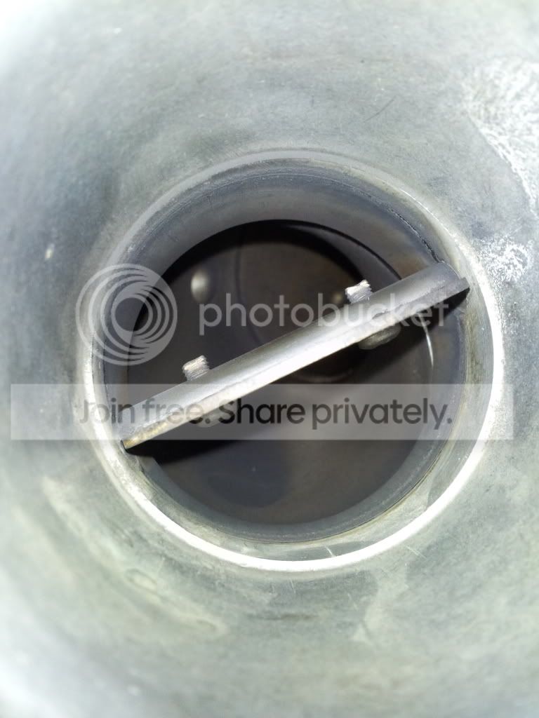

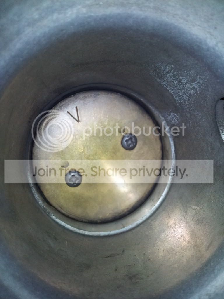

pulled the cover plate off of the intake and found a bunch of oil. it looks as though it might be coming from or going to the vacum lines, im gona pick up a new pcv valve and see if that helps any. the throttle body side has no oil
my friend suggested a leakdown test if the pcv doesnt fix the problem. any other suggestions?

That's why I said to take the cover off, I read something about this style of intake (same as edelbrock) that talked about the uppers always being full of oil. It's something in the design, I'll search through my history and see if I can find it. Obviously there isn't 2 quarts of oil there but it's a start to find the source of your problem

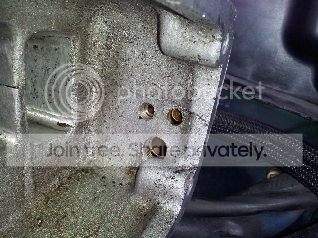

I read up on that and found that the performer and typhoon had a mistake in the design and that they put too much vacuum on the pcv. my friend said I could just run an open pcv valve system. Gut the pcv and put in a catch can then to the valve cover. Anyone else runnin a pcv system like that?

its already hooked up to one of the smaller ports on the intake. i think wt im gona do is just run an open pcv system like my friend is. just gona gut a cheap pcv, run to a catch can and then to the valve cover and cap the vaccum port in the intake and at the intake elbow. that way it returns the oil that gets sucked up into the line and still vents the crankcase pressure.
