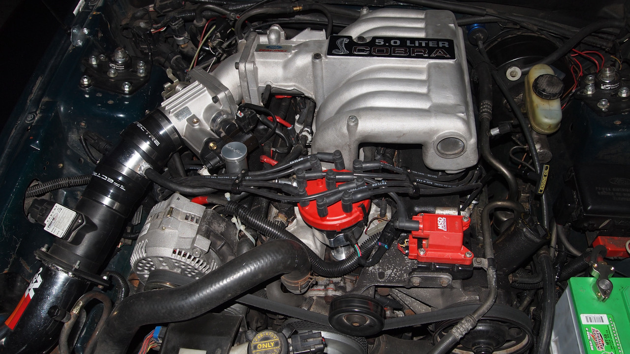

I got the black trick flow valve covers on, they are advertised as 3" high and they clear my rockers and alternator fine. They also look awesome. While I was at it I installed their billet filler neck and cap and very happy how it turned out. Ill post pictures up soon
