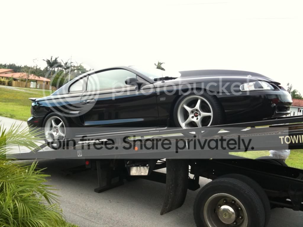

Since I made a new bigger pipe had to put it on a flatbed for a dyno session.

Fuel pressure dropping at the 500 hp mark. Turns out one of the pumps was bad. Should have 2 new ones by end of week and back on the dyno. It was also discovered that I will be making too much boost before redline. In the works will be a eBoost 2 controller and wastegate to maintain boost at save levels up to redline.
