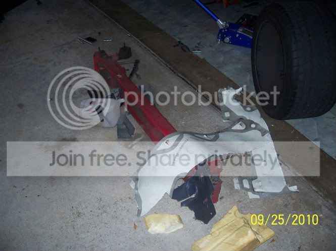

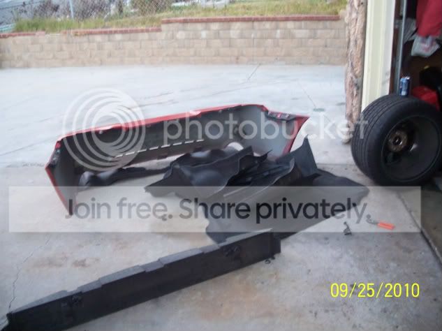

Today i got off my butt and decided to remove the broken front bumper and remove the rear bumper support....over all i took out an estimated 37-40lbs today. :) i took the horn, washer fluid tank out, bumber support as well as some other odds and ends. I looked at the door brace inside the door and i basically was stumped on how i could remove them with out cutting the frame of the door. I also was looking at the battery set up for my new relocation kit i know i have to lower the tank which isn't an issue. What i want to know/ see how the positive lines are run. Do i need to run one to the fuse box and the starter? I tried googling the battery relocation set up on mod motor but there isn't anything solid for me to use, it would be greatly appriciated if anyone could give me a run down on wiring this thing...
