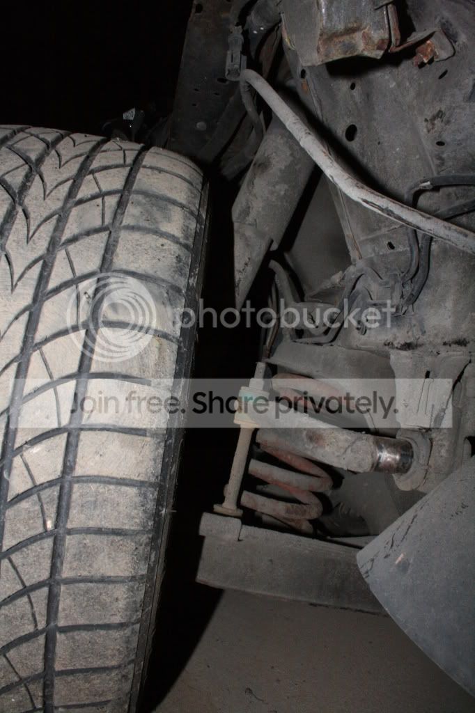

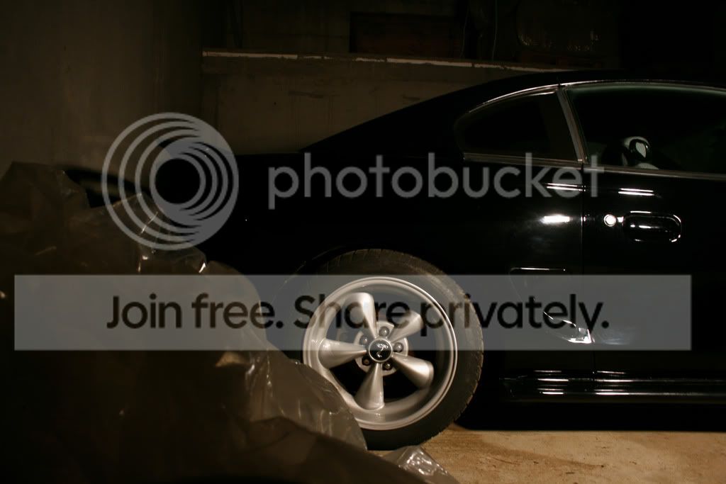

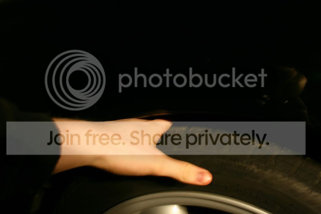

What color are original springs in gt 97??
just wondering if my car is lowered, the springs in my car are red.
do you think he's lowered? is so, what much would you think?

Uh yeah, thats definitely lowered. Our cars look 4x4. That thing is definitely been lowered. Not sure how much but a good amount.

Original springs were black. Looks about the same drop as mine in the rear. I would say around 1-3/4".

My eibach's are red, get in there with a rag and clean them off, more than likely they'll have writing on them saying what brand they are.
27,321
Eibach sportlines are red and they should have 4.1035 as a part number.

unless the stock springs that were cut and painted, which they probably arent, they are some kind of lowering spring, stock is black and the only spring that i can think of thats red-ish is eibach
