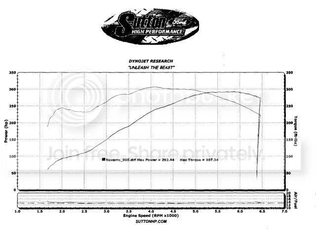

I'm running CMS stage 2 n/a cams and am very happy with them. Below is my dyno graph and a little vid to give you an idea what they sound like at idle.
