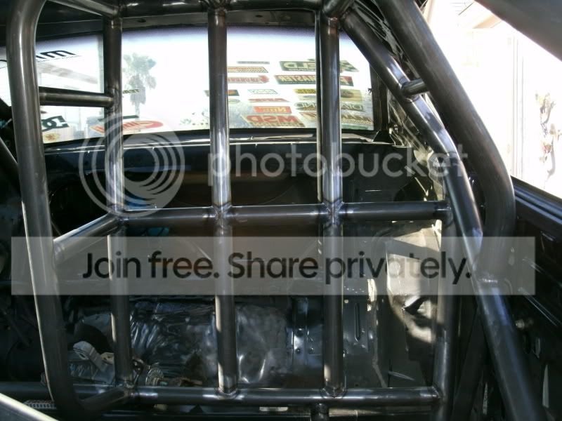

Some of you guys may know MustangMatt, he's planning driving this on the street. This is extreme, but it would definitely not be in my thoughts to drive this anywhere but a track.
